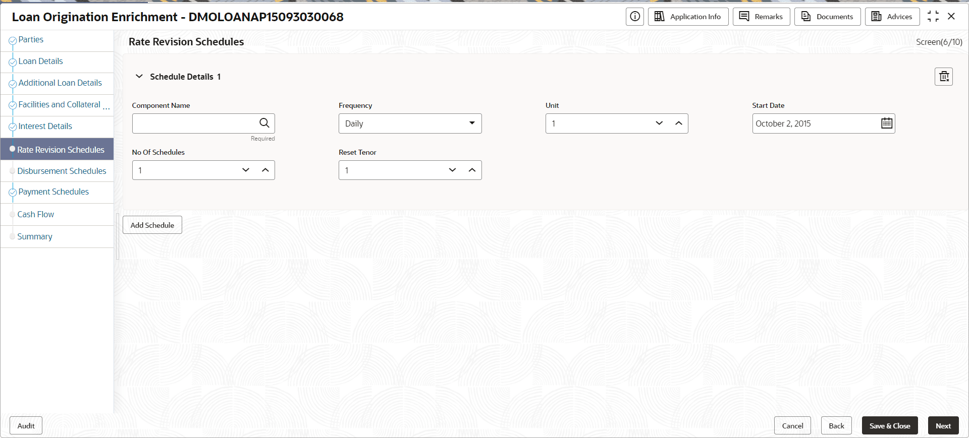

Rate Revision Schedule details can be added for the application in the Enrichment Stage.
  1. Initiate a Loan Origination and navigate to a specific data segment.
  2. From Loan Origination, click Rate Revision Schedules tab and provide the required details.
    The Rate Revision Schedules screen displays.
    For information on the screen fields, refer to the field description table below.
    Figure 1-14 Rate Revision Schedules Screen
    Description of Figure 1-14 follows
    Description of "Figure 1-14 Rate Revision Schedules Screen"
    Table 1-10 Rate Revision Schedules - Field Description
    Field Description
    Component Name Select the component Name of the Rate revision schedule.
    Frequency Select the time interval for which the rate revision would be taking place.
    Unit Select the unit associated with the frequency.
    Start Date Select the date on which rate revision will be applicable.
    No of Schedules Select the number of schedules.
    Reset Tenor Select the reset tenor value. The tenor will be reset to a new value.
