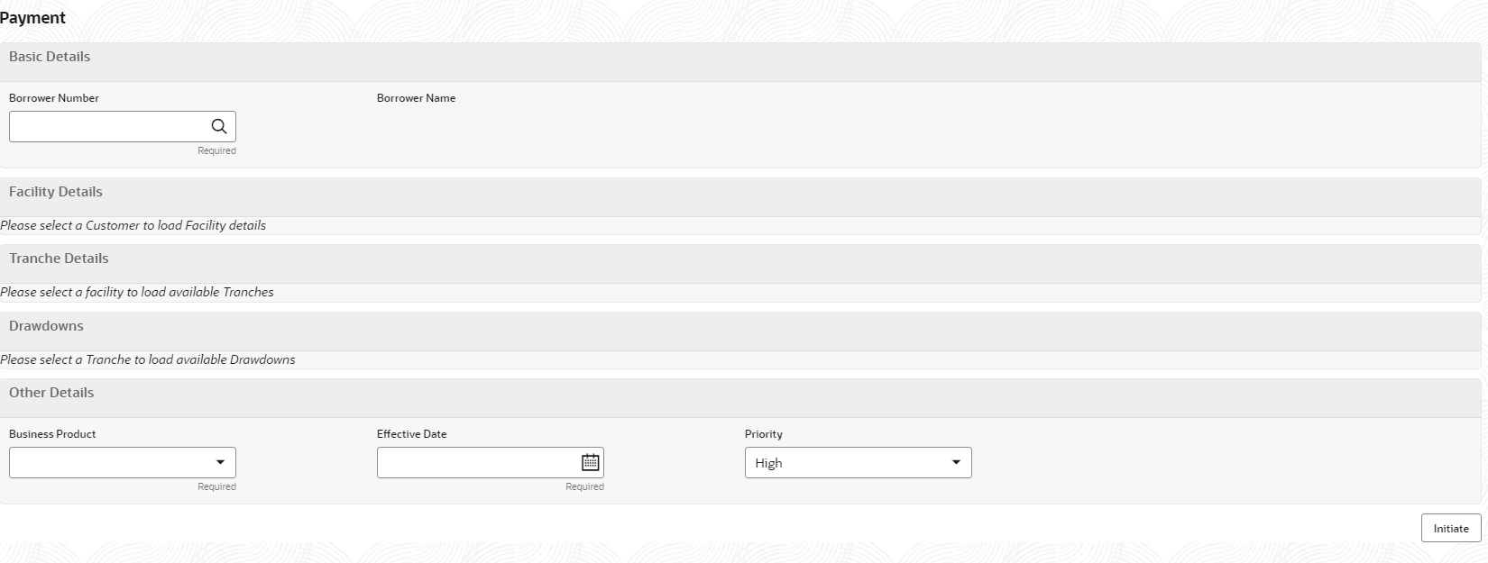

    The Payment Process screen is displayed.Description of syndication-payment.png follows
  3. In the Payment Process screen, provide the required details.
    Table 1-181 Payment Process
    Field Description
     Customer Select the Borrower for which the Loan payment to be made.
    Facility Reference Number Select the Facility Reference Number
    Tranche Reference Number Select the respective Tranche under the Facility
    Contract Reference Number Upon searching the contracts under the Facility and Tranche select the Loan Contract
    Business Product Click Search to view and select the required business product.
    Effective Date Select an effective application date from the dropdown calendar. The system defaults the current system date as the application initiation date.
    Priority Click High/Medium/Low button as per the priority.
  4. Click Initiate to begin the process.
