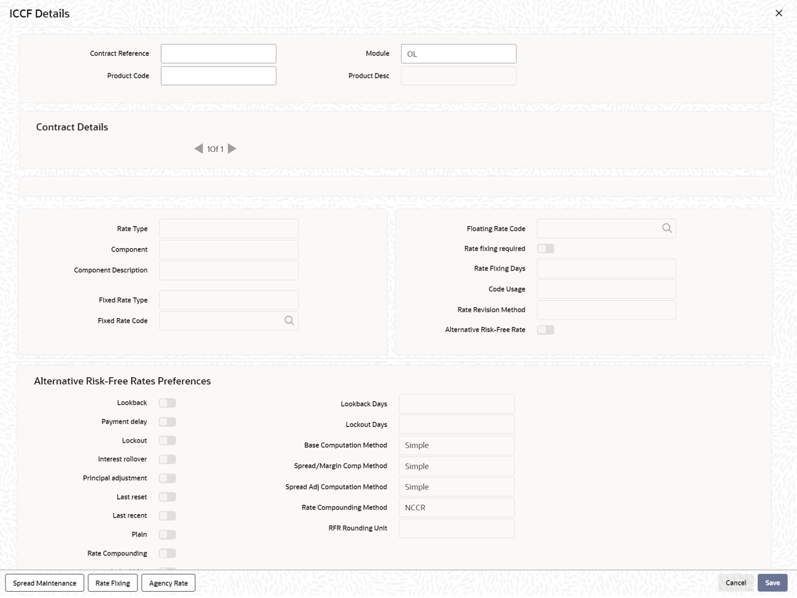

To capture details of ICCF details screen
Specify the User ID and Password, and login to Homepage.- From the Homepage, navigate to Loan and Commitment- Contract Input screen.
- From the Loan and Commitment- Contract Input screen,
click on ICCF.The ICCF Details screen is displayed.

Table 1-14 ICCF Details
Field Description Fixed Rate Type For a Fixed rate type, this indicates whether the rate is user specified or is picked up from the rate maintenance table. The options are: - User Input (U) – This option indicates that the user specifies the rate of interest applicable on the contract.
- Standard (S) – This option indicates that the system picks-up the rate from the Standard Rate Maintenance screen. This rate is a combination of the Standard Rate and Tenorwise Spread.
Special Rate Type System defaults the maintenance done for Special Rate Type in the Interest Limits Maintenance screen. However, you can edit this value and select the special rate type from the adjoining drop-down list. This list displays the following values. - Fixed Rate
- Flat Amount
Fixed Rate Code If the Fixed Rate Type is Standard, this indicates the Standard Rate Code based on which the system pick ups the rate applicable on the contract. This specification is defaulted from the product. However, you are allowed to change it at the time of contract processing.
Penalty Rate Code If pre-payment penalty is allowed for the loan product, select the rate code based on which the system pick-ups the prepayment penalty rate for the contract. This specification is also be defaulted from the product. However, you are allowed to select a different rate code at the contract level.
Revision Method Select the revision method option for the periodic floating type of loans from the list of option provided: - Auto
- Manual
Alternative Risk-Free Rates For information on Alternative Risk-Free Rates, refer to Interest Class Maintenance in this User Manual. Interest Rate Rounding Components The Rate Rounding Rule, Rate Rounding Unit, and Rate Rounding Position values get defaulted from Interest Limits Detail screen. If required, you can change these values. Consider as Discount While defining an interest class for either the loans or the bills module, you can indicate whether the interest component is to be considered for discount accrual on a constant yield basis. The value for this field is defaulted from the Interest Definition and it can be changed here.
