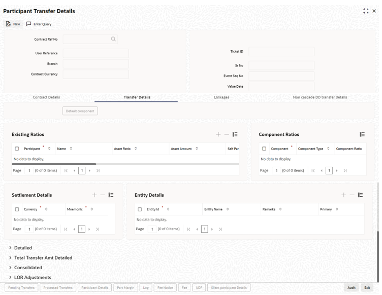

From the Homepage, navigate to Participant Transfer Details screen.
- From the Participant Transfer Details screen, click
Transfer Details.The Transfer Details screen is displayed.
- Check the Detailed section in Transfer
Details tab.To transfer assets between participants, you have to select the participants from the Participant Selection screen and then specify the following for each.Click Add Row button to select the next transferor from the option list provided.
