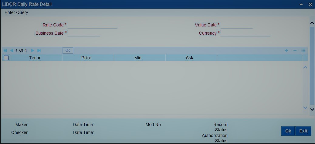

- On the homepage, type LBDPMCFC and click next
arrow.The LIBOR Daily Rate Detail screen is displayed.
The fields which are marked in asterisk red are mandatory fields. - All rates that is received from PMC are displayed below.
Table 2-19 LIBOR Daily Rate Detail
Fields Description Rate Code The system displays the rate code. Currency The system displays the currency. Business Date The system displays the application date on which the rates are received from PMC. Value Date The system displays the same date which is received from the PMC. Tenor The system displays the rates received for the combination of Rate Code, Value Date, Currency and Tenor, with Maker/Checker as SYSTEM. Bid Rate The system displays the rates received for the combination of Rate Code, Value Date, Currency and Tenor, with Maker/Checker as SYSTEM. Mid Rate The system displays the rates received for the combination of Rate Code, Value Date, Currency and Tenor, with Maker/Checker as SYSTEM. For more details on negative rate processing, refer the title Maintaining Loans Parameters Details in the chapter Bank Parameters in Core Services User Manual.
