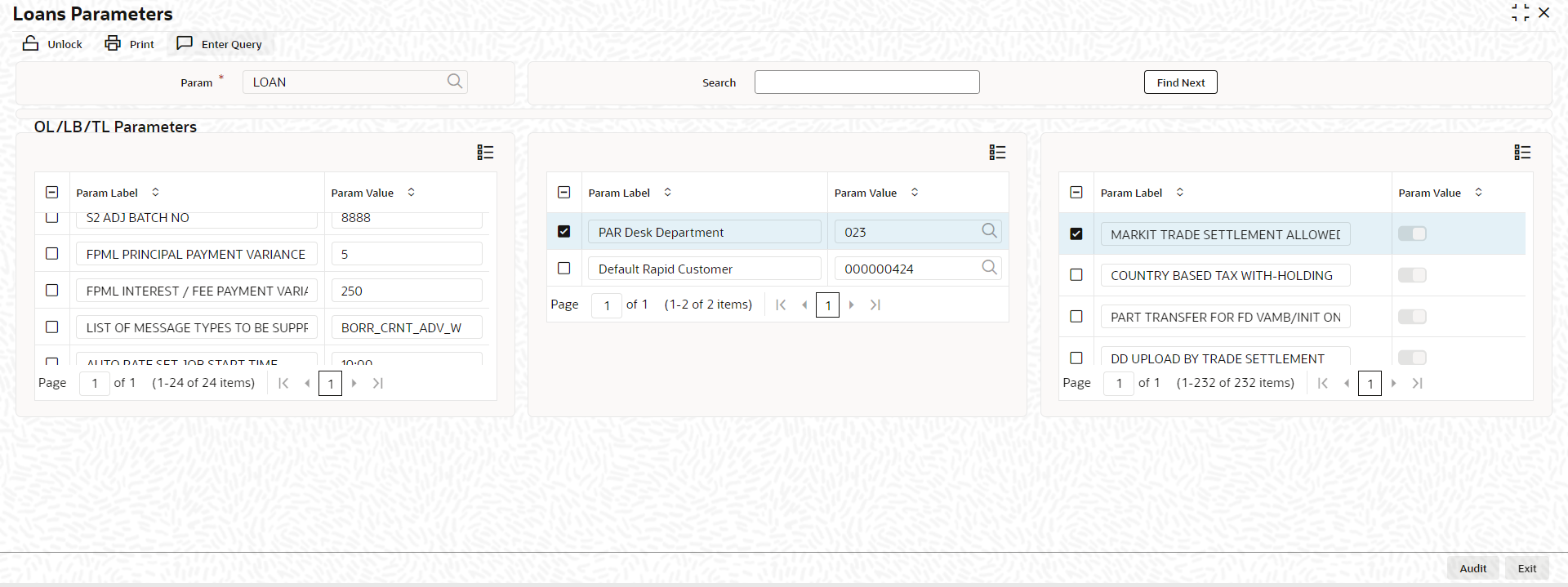

Loan parameter screen.- On the homepage, type OLDLNPRM and click next
arrow.The Loan parameter screen sceen is displayed.
- Through this screen you can view details of the following:
- OL/LB/TL Parameters, Param Label and Param Value

All in rate will be 0 if Base Rate + Spread is negative, in LD module
Selected Not Selected If Base Rate is negative, then base rate will be considered as 0. Margin can be negative.
All in rate will be 0 if Base Rate + Margin is negative, in LS module.
All in rate will be 0 if Base Rate + Spread is negative, in LD module.
Not Selected NA Below listed existing functionalities will continue to work. Both Base Rate and Margin should be positive in LS module.
Both Base Rate and Spread should be 2-32 positive in LD module
For more information on reclassification, refer the section ’Reclassification’ in the chapter ‘Processing an SLT Contract’ of the Secondary Loan Trading User Manual.
- CD Integration Source
Source code used for CD integration
- Trade Integration
Trade integration enabled or not
- Proceed with Previous Rate Available
If Yes - EOD to proceed with latest rate available. If rate for current day isn't available, apply the latest available. Else, EOD to abort.
- Inactive Cust status
If this value is "Y", then the UBS integration to handoff the inactive customers will be enabled.
- Reset Netrate
- If Param value - Y : If Min or Max rate is not null system will reset the Net Rate either to Min/Max if it is not in the given min/max range
- If Param value - N : If Min or Max rate is not null system will validate the Net Rate with Min/Max rate and system throws error "Rate must be more than minimum defined at product level".
- Consider Prev Sch Compound amt
Used when schedule type is selected as "Compounding".
- If this flag is Yes, then System will add the compounded amount for the previous schedule with the basis amout of the next schedule.
- If this flag is No, then System will not add the compounded amount with the basis amount of next schedule.
- Enable ELCM Blocking During Booking
If this flag is Yes, then system would send a block request for future dated disbursement to ELCM to block the facility/line.
- Enable Transaction Beyond Previous Month
- If this value is ”Y”, then system would allow posting of back dated transactions for any period.
- If this value is “N”, then system would allow posting of back dated.
- De Accelartion Allowed
If Yes - then, De-acceleration will be allowed already credit accelerated loan.
- Bulk Processing Limit
This value determines the number of records to be committed in a bulk transaction during penalty processing batch.
- Revision on rate fixing Date
If Yes - For FPA drawdowns fire revision event on rate fixing date itself if rate is available on BOD.
- Stop payment delay for PRINCIPAL
If Yes - then Payment Delay to be allowed only for Interest components.
Pay by date is not applicable for Principal, instead should liquidate on due date.
- Proceed with child contract processing
If Yes child contracts will be created via job when rollover details are captured before maturity date of contract or if split reprice value date lies in future
Parent topic: Automatic Processing
