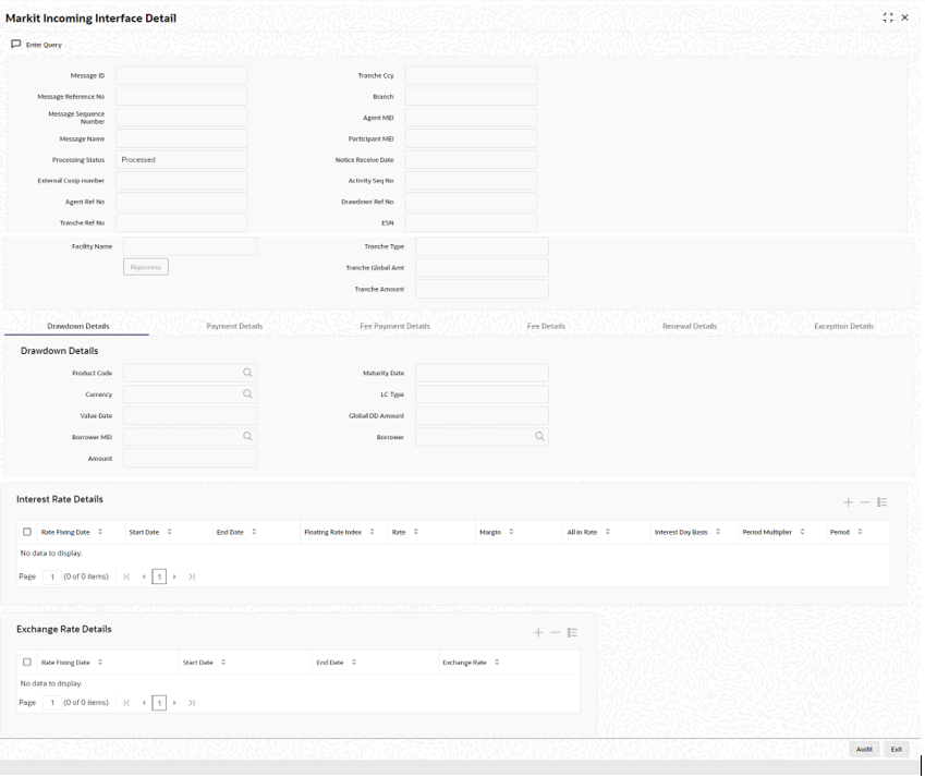

15.17.6 Drawdown Notice
The incoming messages with Message Name as Drawdown Notice and Drawdown Event Type as New Drawdown Event is placed in the Incoming Browser with Processing Status as Pending. You can view and process it by clicking Drawdown Details tab against the message.
