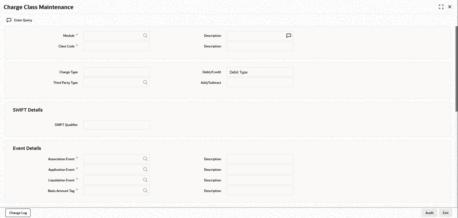

You can define the attributes of a charge class in the Charge Class Maintenance screen.
To capture details of charge class maintenance screen
Specify the User ID and Password, and login to Homepage.
  1. On the Homepage, type LFDCHGCE and click next arrow.
    The Charge Class Maintenance screen is displayed.
    The fields which are marked in asterisk red are mandatory fields.
    Figure 1-3 Charge Class Maintenance
  2. You can enter below details in this screen. For information on fields, refer to the field description table.
    Table 1-5 Charge Class Maintenance
