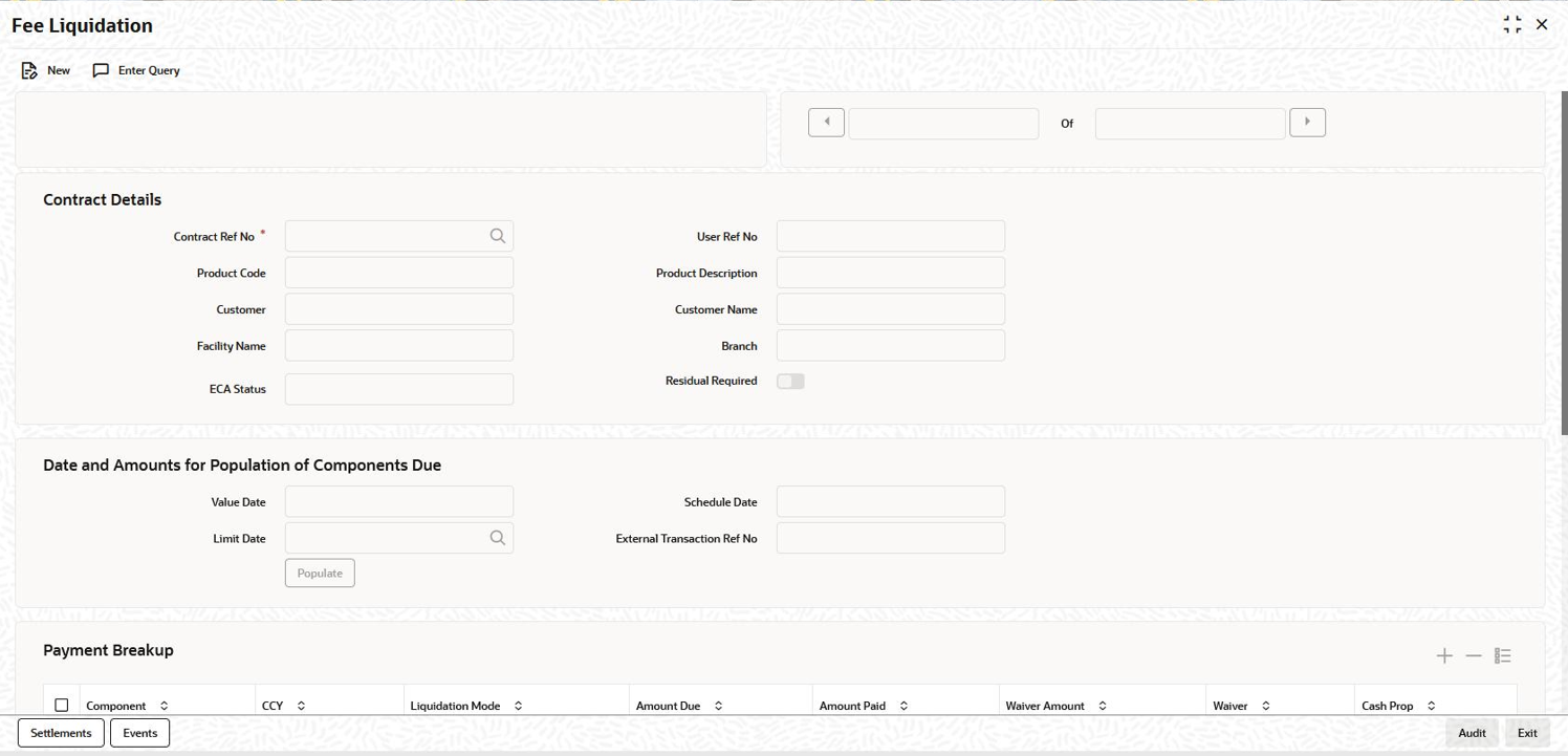

  1. On the Homepage, type OLDFEELQ and click next arrow.
    The Fee Liquidation screen is displayed.
    The fields which are marked in asterisk red are mandatory fields.
  2. To liquidate a fee component schedule, do the following:
    1. Select the contract for manual liquidation.
    2. Click on the new button - Click New from the menu. The Value Date and Limit Date displays the current system date. The accounting entries for liquidation is passed as of the value date.
    3. You can change the value date, if required. However, if you specify a back valued date, it cannot be earlier than the last schedule that was paid. The date you capture here is the date on which liquidation occurs.
    4. You can also change the limit date. This date indicates the date upto which you want to make the payment. This may include future schedules as well as unpaid past schedules. Again, a back valued limit date should not be earlier than the last liquidation date. In addition, you can specify a limit date beyond the contract maturity date.
    5. After capturing the value date and the limit date, click the Populate button. The system displays all the components which are due till the limit date (both unpaid past and future schedules till the limit date). The following details are displayed in the Payment Breakup section of the screen:
