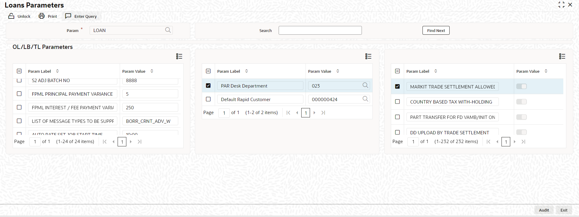

Loan parameter screen.- On the homepage, type OLDLNPRM and click next
arrow.The Loan parameter screen sceen is displayed.
- Through this screen you can view details of the following:
- OL/LB/TL Parameters, Param Label and Param Value
- Markit Trade Identifier
System displays the value of ‘Markit Trade Identifier’ as ‘MarkitClear’. However, you can edit this value
If the trade id from the incoming Markit message matches with the ‘Markit Identifier’, then the trade id value is the Markit Trade id and the other trade id is the LQT ticket id.
- S2 Adj Batch No
Specify the batch number for the S2 interface.
- FpML Principal Payment Variance
Specify the FpML Principal Payment Variance
- Swift Address
Specify the SWIFT address for for payment transaction. Multiple SWIFT address can be input here using a ‘~’ separated list.
The system checks for the Swift address before performing sanction check for a payment transaction.
- Archival Days
Specify the archival days for the payments which are not handed off from Oracle FLEXCUBE.
- PAR Desk Department
Select the Par desk department code from the adjoining option list. This list displays all the valid department codes maintained in the system. You can select the appropriate one. This code is used for par desk line trade (Par buying/selling from Origination – PL Trade) booked in the system through the external system Loans QT and is applicable throughout the life cycle of the trade.
For trades uploaded from the Loans QT, the department code is resolved based on the ‘PAR Desk Department’ code you have maintained here. If the ‘PAR Desk Department’ code is not maintained here, then the generic department code is defaulted for the trade. This defaulted department code is applicable throughout the life cycle of the trade.
For trades input manually through the ‘Secondary Loan Trading – Draft Trade’ screen, system validates to check that you have booked a Par desk line trade (PL trade) only with the default department code. Else, system displays the following error message:
‘User input department code not matching with the ‘PAR Desk Department Code’ along with the indication of the value maintained for the parameter’.
The Par desk department code, which is used as the department code for trades uploaded from external system Loans QT, is used for this validation.
This validation is carried out only if ‘PAR Desk Department’ is maintained here.

All in rate will be 0 if Base Rate + Spread is negative, in LD module
Selected Not Selected If Base Rate is negative, then base rate will be considered as 0. Margin can be negative.
All in rate will be 0 if Base Rate + Margin is negative, in LS module.
All in rate will be 0 if Base Rate + Spread is negative, in LD module.
Not Selected NA Below listed existing functionalities will continue to work. Both Base Rate and Margin should be positive in LS module.
Both Base Rate and Spread should be 2-32 positive in LD module
For more information on reclassification, refer the section ’Reclassification’ in the chapter ‘Processing an SLT Contract’ of the Secondary Loan Trading User Manual.
- CD Integration Source
Source code used for CD integration
- Trade Integration
Trade integration enabled or not
- Proceed with Previous Rate Available
If Yes - EOD to proceed with latest rate available. If rate for current day isn't available, apply the latest available. Else, EOD to abort.
- Inactive Cust status
If this value is "Y", then the UBS integration to handoff the inactive customers will be enabled.
- Reset Netrate
- If Param value - Y : If Min or Max rate is not null system will reset the Net Rate either to Min/Max if it is not in the given min/max range
- If Param value - N : If Min or Max rate is not null system will validate the Net Rate with Min/Max rate and system throws error "Rate must be more than minimum defined at product level".
- Consider Prev Sch Compound amt
Used when schedule type is selected as "Compounding".
- If this flag is Yes, then System will add the compounded amount for the previous schedule with the basis amout of the next schedule.
- If this flag is No, then System will not add the compounded amount with the basis amount of next schedule.
- Enable ELCM Blocking During Booking
If this flag is Yes, then system would send a block request for future dated disbursement to ELCM to block the facility/line.
- Enable Transaction Beyond Previous Month
- If this value is ”Y”, then system would allow posting of back dated transactions for any period.
- If this value is “N”, then system would allow posting of back dated.
- De Accelartion Allowed
If Yes - then, De-acceleration will be allowed already credit accelerated loan.
- Bulk Processing Limit
This value determines the number of records to be committed in a bulk transaction during penalty processing batch.
- Revision on rate fixing Date
If Yes - For FPA drawdowns fire revision event on rate fixing date itself if rate is available on BOD.
- Stop payment delay for PRINCIPAL
If Yes - then Payment Delay to be allowed only for Interest components.
Pay by date is not applicable for Principal, instead should liquidate on due date.
- Proceed with child contract processing
If Yes child contracts will be created via job when rollover details are captured before maturity date of contract or if split reprice value date lies in future
- Include Duplicate to Non-Primary Entities
If borrower/participants have multiple entities system generates original advice to primary entities. For non-primary entities system will add COPY - Avoid Duplication to the first line of advice generated.
- Restrict Value Date Balance update
Check this box to restrict VD Balance updates for commitments without fees.
- Bulk External Customer Check Request
Check this box to send the Query Customer calls in bulk via ECA to all parties involved in a contract. If this is off, it will send one request per customer.
- Allow Parent Contract Liquidate on Rollover Failure
Check this box to indicate that the parent contract should be allowed to liquidate manually for exceptional cases where Rollover fails.
- Skip Penalty Recalculation ON Revision
If this value is "Y", then penalty calculation will be skipped during rate revision.
