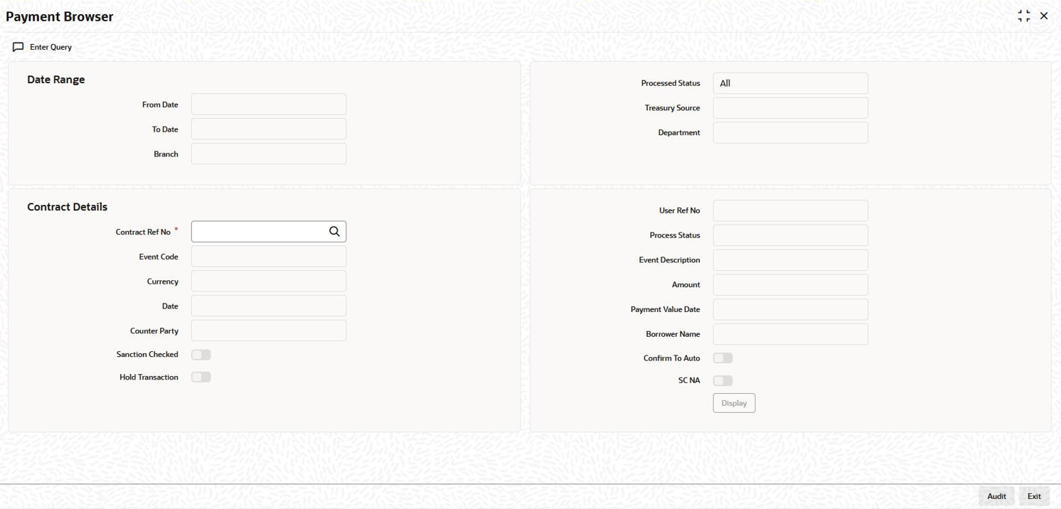

- On the homepage, type LBDFWDPR and click next
arrow.The Payment Browser screen is displayed.
The fields which are marked in asterisk red are mandatory fields.Figure 5-85 Payment Browser
- By default, Hold Transaction check box is not selected
and you can select this check box for interest and principal payments You need
to query for the contract in the FP browser. You can click
Unlock and select the Hold
Transaction check box and save the record.Once the this check box is selected, systematically the Confirmed to Auto check box is cleared and disabled. Even though if the Confirmed to Auto check box is selected for a transaction before it is held, once you select Hold Transaction check box, the Confirmed to Auto check box is cleared and disabled systematically.
