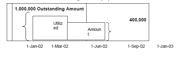

The details of the commitment are diagrammatically represented below:
In the above representation, the shaded area represents the outstanding amount of the commitment and non-shaded area represents the amount utilized by the customer.
With reference to the above illustration, we are assuming that the schedules for the commitment are on 1st march 2002, 1st June 2002 and 1st September 2002. Further, we assume that the utilized amount between 1st September 2002 and 1st January 2003 is USD 400,000.Keeping these details in view, system calculates the fee accrual amount as shown below:Start Date End Date Basis Amount No of Days Total Accrual Amount Daily Avg Accrual Amount 1-Jan-02 1-Mar-02 0.00 Basis Amount = Utilized Amount
59 0.0 0.0 1-Mar-02 1-Jun-02 1,000,000.00 92 2,000x[1,000,000x92] [92x1, 000,000 + 92x400, 000] = 1,428.57 1,428.57/92 =15.52795031 1-Jun-02 1-Sep-02 400,000.00 (We are assuming that this is the utilized amount)
92 2,000 x [400,00x92] [92x1,000,000+92x400,0 0] =571.43 571.43/92= 6.211180124 1-Sep-02 1-Jan-03 0.00 122 0.0 0.0
