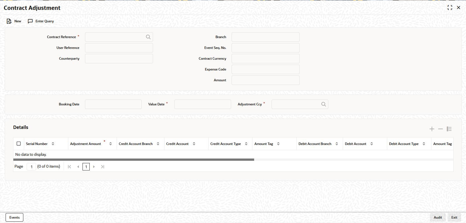

You can post manual adjustment entry in Contract Adjustment
screen.
Specify the User ID and
Password, and login to Homepage.
- On the homepage, type OLDLDENT and click next
arrow.The Contract Adjustment screen is displayed.
The fields which are marked in asterisk red are mandatory fields. - You can maintain below details in this tab. For information on fields, refer to
the field description table.On selecting the New Operation, You have to specify the following details.
Table 4-25 Contract Adjustment
Fields Description Contract Reference Number Select the contract reference number from the adjoining option list. The list displays the contract reference numbers that are maintained in the system. Once the contract reference number is selected, the following contract details are displayed:- User Reference Number

Contract Ccy Specify the contract currency. Booking Date Specify the booking date of the contract. Value Date Specify the value date of the contract. Adjustment Ccy Select the adjustment currency from the adjoining option list. All the adjustment entries are posted only using the currency specified here. Table 4-26 Contract Details
Field Description Serial Number Specifies the serial number of the contract. Adjustment Amount Specify the adjustment amount of the contract. CR Acc Branch The system defaults the contract branch. However, you can modify it by selecting a branch from the adjoining option list. Credit Account Select the account that is to be credited from the adjoining option list. Credit Account Type The system defaults the credit account type once the credit account is selected. DR Acc Branch The system defaults the contract branch. However, you can modify it by selecting a branch from the adjoining option list. Debit Account Select the account that is to be debited from the adjoining option list. (Notes:- You are allowed to post Multiple Adjustments accounting entry for a contract in an Adjustment activity.
