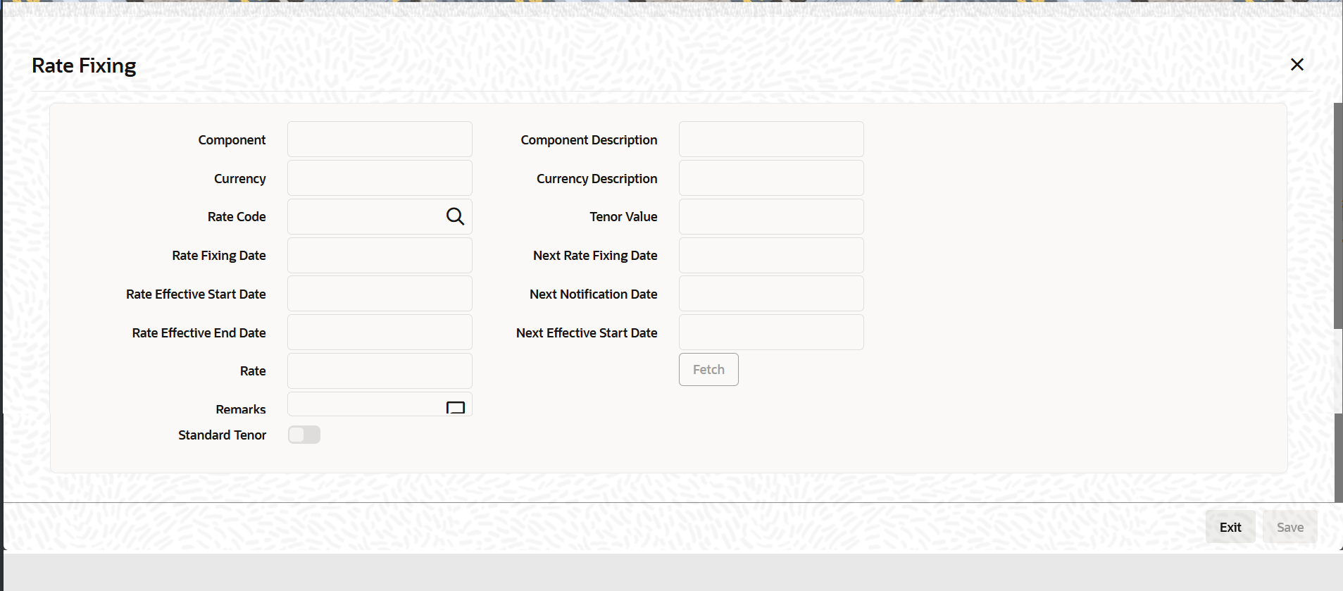

Rate Fixing Details screen
Specify the User ID and Password, login to Homepage.
From the Homepage, navigate to Drawdown Contract Detail screen.
From the Drawdown Contract Detail screen, click Interest.
  • The ICCF Details screen is displayed.
From the ICCF Details screen, click Rate Fixing.
  • The Rate Fixing screen is displayed.
You can specify the following details in the Rate Fixing Details screen:
Table 5-10 Rate Fixing Details
Fields Description
Rate Code You have to specify the floating rate code based on which you can specify the interest rate fixing tenor and the default fixing rate.
Tenor Value You can specify the rate fixing period by specifying a Tenor Value or the Rate Effective End Date. If you are specifying a tenor, you can select a value from the option list which displays the tenor values associated with the rate code you select. This is based on your maintenance in the Floating Rate Code Definition screen. Upon choosing a value, the following details are also displayed:
  • Tenor Unit
  • Next Rate Fixing Date
  • Next Notification Date
  • Next Effective Start Date
  • Rate Effective End Date
  • Rate
Rate Effective End Date If you do not want to specify a Tenor Value, you have the option to capture the end date of the rate fixing period. This date should not be less than or equal to the Rate Effective Start Date. The system displays the following after you specify the end date:
  • Rate
Rate The system defaults the interest rate based on the rate code and the tenor value/effective end date you specify for the drawdown. You can change the default rate, if required.
If the base rate is changed or new rate is added or the floating rate codes are changed, the system recalculates the interest. Note that it considers the margin rates maintained for the participants while recalculating the interest due for the participants.
For more details on negative rate processing, refer the title Maintaining Loans Parameters Details in the chapter Bank Parameters in Core Services User Guide.
Remarks You can also capture additional information, if required. This is used only for information purposes.
Click the Ok button to save and exit the screen.
