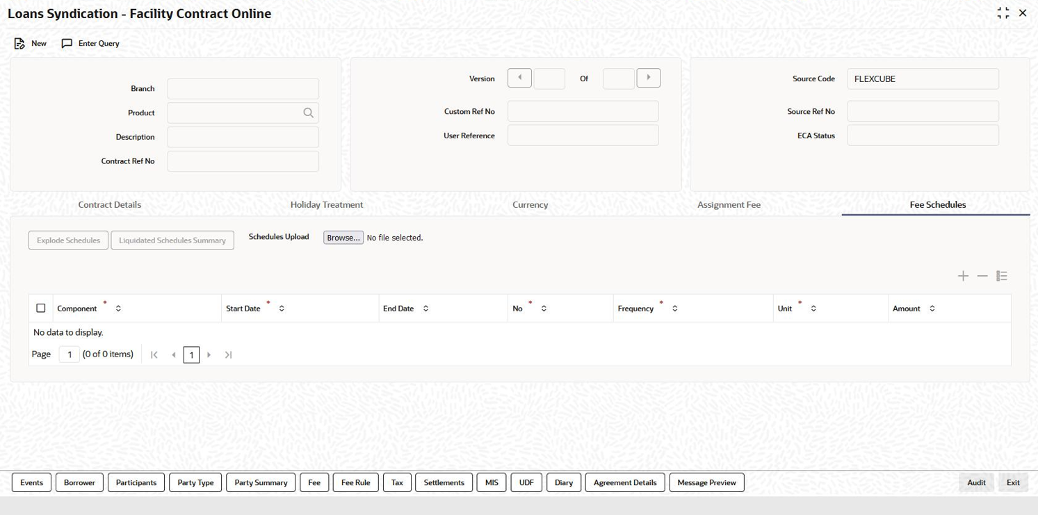

From the homepage, navigate to Loans Syndication - Facility Contract Online screen.
- From the Loans Syndication - Facility Contract Online
screen, click Fee Schedules.The Fee Schedules screen is displayed.
- You can capture the following details in this screen. For information on
fields, refer to the field description table.
Table 4-11 Fee Schedules
Field Description Schedules Upload You can upload fee schedules for facility contracts using this option. You can upload file only with *.csv extension. The fee schedules file must meet the following criteria.- Contains only fee components associated with the product.

Component The fee components that have been associated with the product are available in the option list. Select a component from this list. Upon selection of the component, the Schedule Start Date, Frequency and Unit are also displayed. You can change the default values. Sch Start Date This is the date on which the schedule for the fee component for the borrower facility begins. By default, this is equal to the fee Association Date. The first schedule would fall due on this date. You can change the date to any date that falls between the Association Date and the Facility End Date. No. You must specify the number of schedules that would apply to the fee component of the borrower contract. If you define a single schedule (that is, the number of schedules is one), Oracle Banking Corporate Lending initiates one schedule on the start date mentioned, not taking into account the frequency and the frequency unit.

Frequency Select the periodicity at which the schedules must be initiated, with the first schedule on the start date mentioned. The options available are: - Daily

Unit You can specify the units in which the specified frequency are reckoned. For instance, consider a contract with the following details: - Frequency: Monthly

Amount If the Basis Amount Tag of the fee component is User Input (as specified in the Borrower Product – Fee Details screen), you can capture the amount to be liquidated towards the fee component on the schedule date. For all other Basis Amount Tags, the system computes the fee amount based on utilization. For more details on defining fee components, refer the heading Associating a Fee Class or Fee Rule with a product in the Processing Charges and Fees chapter of this User Manual.
