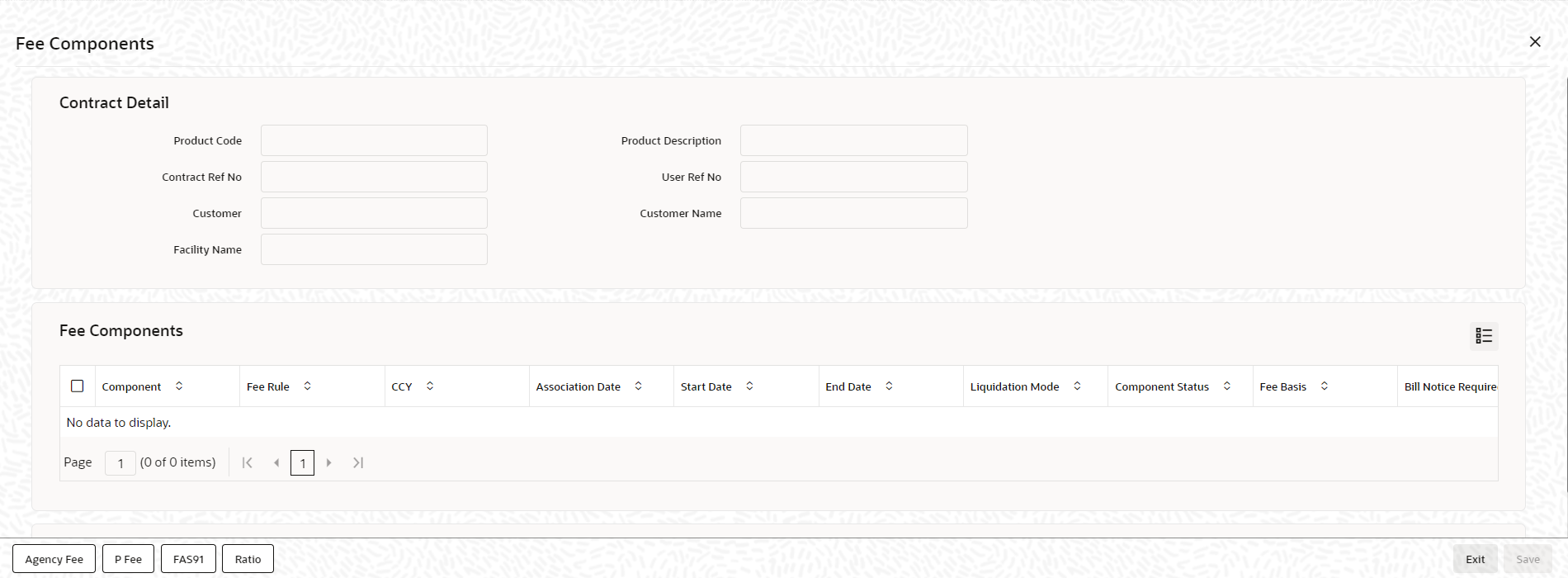

4.5.6 Specify Facility Fee Details
The fee components defined for the underlying facility product becomes applicable to the contract. To view the fee details, click Fee.
The following details of the components are displayed based on the product used:
- Component name
- Fee Rule, if applicable
- Fee Currency
- Date of Association of the component with the contract. This is equal to the current system date.
- Component Start Date
- Component End Date
- Mode of liquidation, whether Auto or Manual
- Status of the component. On the schedule start date, the status will be Active. The system automatically updates the status to Liquidated when the all the schedules of the component is liquidated.
- The fee basis to calculate the fee amount for schedules. This is defaulted from the product level.
- Whether Billing Notice should be generated for the contract
- Billing notice days required
- Whether this FEE component should be considered for Discount Accrual.
- If the fee end date is less than the current business date, then the Fee Reversed box is selected automatically.
