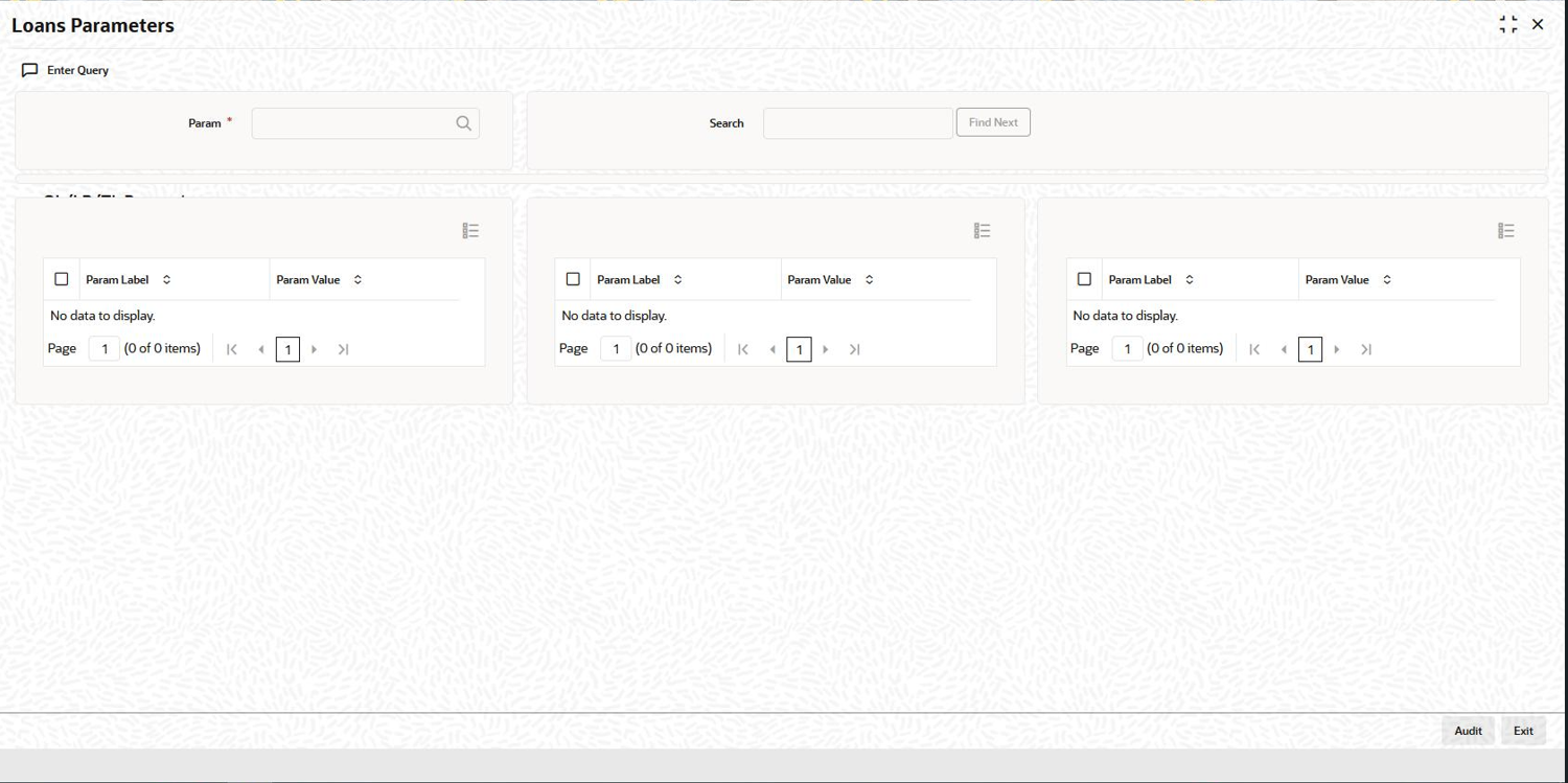

4.18.5 Specifying options in Loan Parameters screen
To capture details of combined ticket settlement authorization screen
Specify the User ID and Password, and login to Homepage.
- On the homepage, type OLDLNPRM and click next
arrow.The Loans Parameters screen is displayed.
The fields which are marked in asterisk red are mandatory fields. - You can specify the following options in Loans
Parameters screen.
