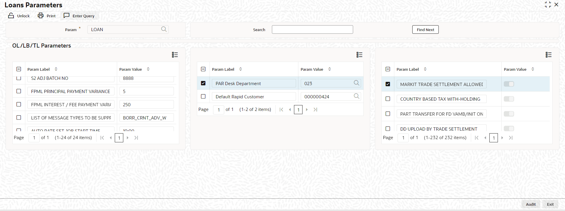

Loan parameter screen.- On the homepage, type OLDLNPRM and click next
arrow.The Loan parameter screen sceen is displayed.
- Through this screen you can view details of the following:OL/LB/TL Parameters, Param Label and Param Value

All in rate will be 0 if Base Rate + Margin is negative, in LS module.
All in rate will be 0 if Base Rate + Spread is negative, in LD module.
Not Selected NA Below listed existing functionalities will continue to work. Both Base Rate and Margin should be positive in LS module.
Both Base Rate and Spread should be 2-32 positive in LD module
For more information on reclassification, refer the section ‘Reclassification’ in the chapter ‘Processing an SLT Contract’ of the Secondary Loan Trading User Manual.
- CD Integration Source
Source code used for CD integration
- Trade Integration
Trade integration enabled or not
- Proceed with Previous Rate Available
If Yes - EOD to proceed with latest rate available. If rate for current day isn't available, apply the latest available. Else, EOD to abort.
- Inactive Cust status
If this value is "Y", then the UBS integration to handoff the inactive customers will be enabled.
- Reset Netrate
- If Param value - Y : If Min or Max rate is not null system will reset the Net Rate either to Min/Max if it is not in the given min/max range
- If Param value - N : If Min or Max rate is not null system will validate the Net Rate with Min/Max rate and system throws error "Rate must be more than minimum defined at product level".
- Consider Prev Sch Compound amt
Used when schedule type is selected as "Compounding".
- If this flag is Yes, then System will add the compounded amount for the previous schedule with the basis amout of the next schedule.
- If this flag is No, then System will not add the compounded amount with the basis amount of next schedule.
- Enable ELCM Blocking During Booking
If this flag is Yes, then system would send a block request for future dated disbursement to ELCM to block the facility/line.
- Enable Transaction Beyond Previous Month
- If this value is ”Y”, then system would allow posting of back dated transactions for any period.
- If this value is “N”, then system would allow posting of back dated.
- De Accelartion Allowed
If Yes - then, De-acceleration will be allowed already credit accelerated loan.
- Bulk Processing Limit
This value determines the number of records to be committed in a bulk transaction during penalty processing batch.
- Revision on rate fixing Date
If Yes - For FPA drawdowns fire revision event on rate fixing date itself if rate is available on BOD.
- Stop payment delay for PRINCIPAL
If Yes - then Payment Delay to be allowed only for Interest components.
Pay by date is not applicable for Principal, instead should liquidate on due date.
- Proceed with child contract processing
If Yes child contracts will be created via job when rollover details are captured before maturity date of contract or if split reprice value date lies in future
- Include Duplicate to Non-Primary Entities
If borrower/participants have multiple entities system generates original advice to primary entities. For non-primary entities system will add COPY - Avoid Duplication to the first line of advice generated.
- Restrict Value Date Balance update
Check this box to restrict VD Balance updates for commitments without fees.
- Bulk External Customer Check Request
Check this box to send the Query Customer calls in bulk via ECA to all parties involved in a contract. If this is off, it will send one request per customer.
- Allow Parent Contract Liquidate on Rollover Failure
Check this box to indicate that the parent contract should be allowed to liquidate manually for exceptional cases where Rollover fails.
- Skip Penalty Recalculation ON Revision
If the parameter value is "Y", then penalty calculation will be skipped during rate revision.
- MULTI_EMAIL_IN_ENTITY
When this flag is selected, multiple email IDs can be entered in the Email ID field under Customer Entity Details, using semicolon (;) as the delimiter. Thus, advice messages can be sent to multiple parties.
- SCHWISE_ACCR_BV_BOOK_VAM_LIQ
- When the parameter value is set to Y, the system will consider the schedules starting from the value date of the back-dated operation and initiate catch-up accrual posting on a schedule basis until the application date.
- When the parameter value is set to N, the system will post the consolidated accruals.
- CHANGE_DD_STATUS_TO_ACTV_FROM_LIQD_ON_MARGIN_REVN
- If this parameter value is set to Y, the system will consider the liquidated contracts for the margin revision processing.
- If this parameter value is set to N, the system will not consider the liquidated contracts for the margin revision processing.
- INTERPOLATE_WITH_ACTUALDAYS
This field decides whether to use actual calendar days or predefined tenors from the Floating Rate Input screen (CFDFLTRI) for interpolation calculations. The default value is Y. Change it to N to use the predefined tenors from CFDFLTRI.
- Markit Trade Identifier
