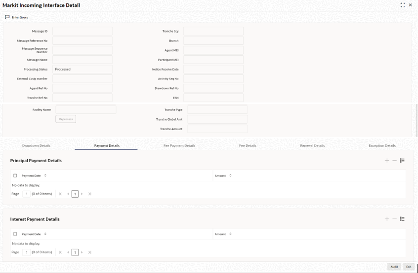

Incoming messages with Message Name as Interest Payment Notice is placed in the Incoming Browser with Processing Status as Pending. You can view and process it by clicking Interest Payment Details button against the message.
Figure 14-7 Interest Payment Details
