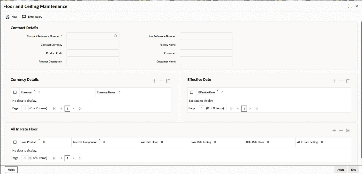

  1. On the homepage, type OLDFLRCL and click next arrow.
    The Floor and Ceiling Maintenance screen is displayed.
    The fields which are marked in asterisk red are mandatory fields.
    Figure 4-42 Floor and Ceiling Maintenance
  2. You can enter below details in this screen. For information on fields, refer to the field description table.
