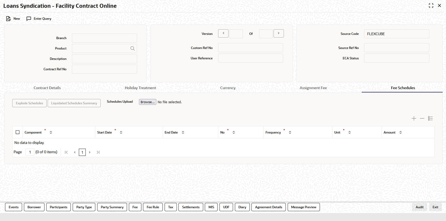

You can specify schedules for fee components through the Fee Schedules screen.
From the homepage, navigate to Loans Syndication - Facility Contract Online screen.
  1. From the Loans Syndication - Facility Contract Online screen, click Fee Schedules.
    The Fee Schedules screen is displayed.
  2. You can capture the following details in this screen. For information on fields, refer to the field description table.
    Table 4-11 Fee Schedules
    Field Description
