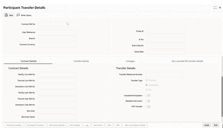

5.11 Transferring Participant Assets
- On the Homepage, type LBDPTFR and click next
arrow.The Participant Transfer Details screen is displayed.
The fields which are marked in asterisk red are mandatory fields. - The specification for Cascade Participation (whether
selected or not) defaults from the contract . When you execute a participant
transfer at the tranche level and the Cascade
Participation option is selected for the tranche, the impact of
the transfer automatically affects all the drawdowns under the tranche. However,
if the option is not selected, you are required to update the underlying
drawdowns manually. In this case, only new drawdowns, processed subsequent to
the transfer reflects the changes.When you specify the transfer percentage for a transfer instruction, the system arrives at the transfer amount based on the existing actual balance as on the value date of the instruction. In this case, it does not consider the impact of the unauthorized PRAM instructions. You cannot authorize a transfer instruction if there are other unauthorized events like CAMD, LIQD, and so on under the tranche/drawdown.

You can use the Participant Transfer Details screen for the following purposes:The following table lists out the events associated with future dated participant transfer.- To transfer assets from an existing participant to another
- To add new participants within the Tranche/Drawdown contract
