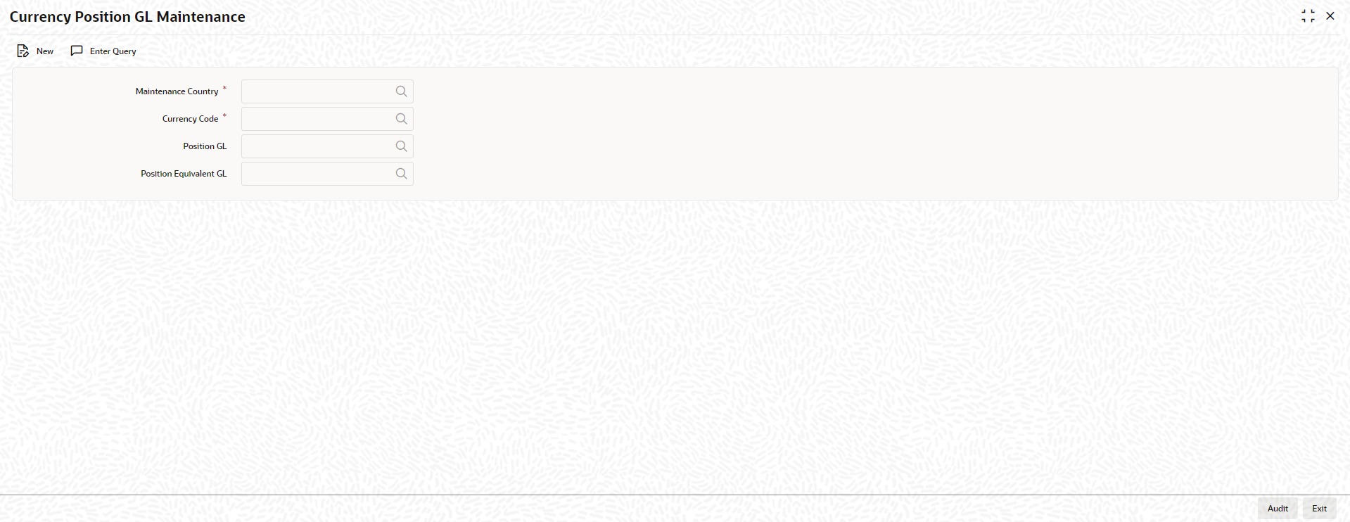

  1. On Homescreen, type CYDPOSGL in the text box, and click Next.
    The Currency Position GL Maintenance screen displays.
    Figure 1-11 Currency Position GL Maintenance
  2. On the Currency Position GL Maintenance screen, specify the fields.
    Table 1-13 Currency Position GL Maintenance - Field Description
    Field Description
    Maintenance Country Click Search and specify the Maintenance Country for which the currency is maintained from the list of values. The list displays all the authorized and open country codes along with their description maintained in the system.
    Currency Code Click Search and specify the Currency Code from the list of values. Currencies are identified in Oracle FLEXCUBE Universal Banking by the SWIFT codes assigned to them. The currency will be identified by this code in all transactions that involve it.
    Position GL and Position Equivalent GL If the user has opted for position accounting in the bank, then maintain the same using CYDPOSGL (Currency Position GL Maintenance) screen to indicate the Position GL and the Position Equivalent GL.
    When maintaining GLs in the bank, the user can opt to link different foreign currencies associated with GL to either of the following:
    • The Position GLs that are specified here (for the corresponding currency)
    • Position GLs of the user's choice
  3. Click Exit to end the transaction.
