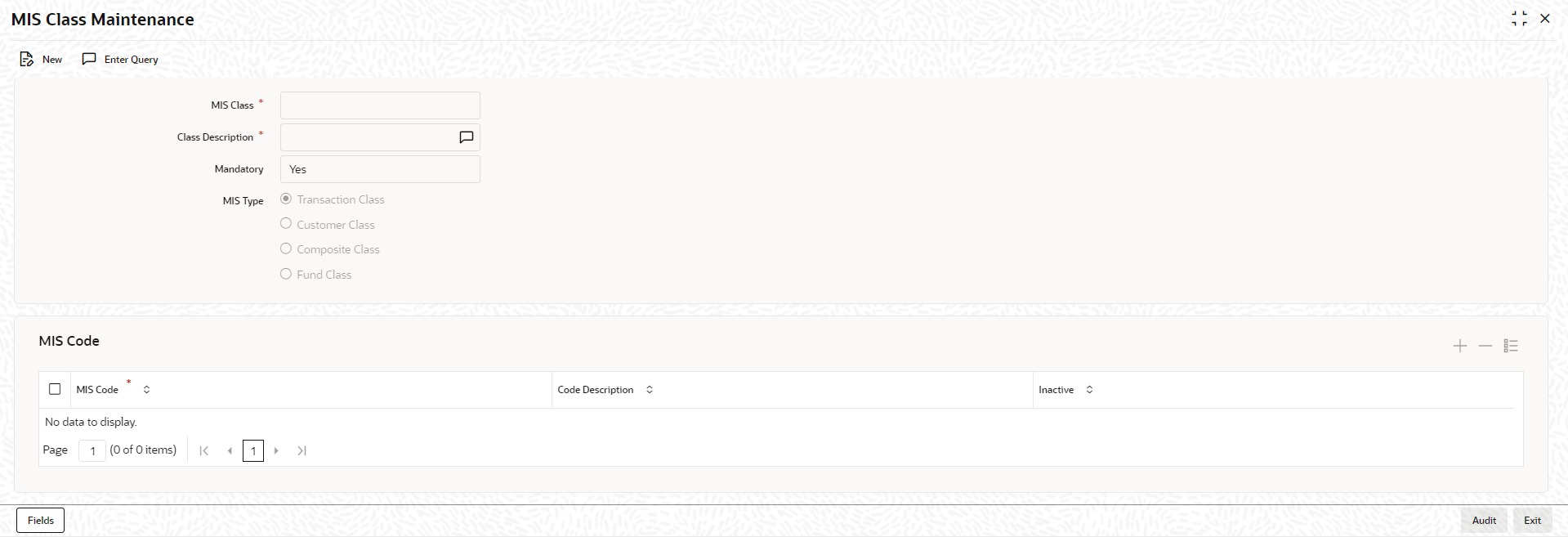

  1. On Homescreen, type GLDCLSMT in the text box, and click Next.
    The MIS Class Maintenance screen displays.
    Figure 1-51 MIS Class Maintenance
    In this screen, the user can define various categories based on which reports on general ledgers should be classified. To maintain details of a new MIS class, click New.
  2. On the MIS Class Maintenance screen, specify the fields.
