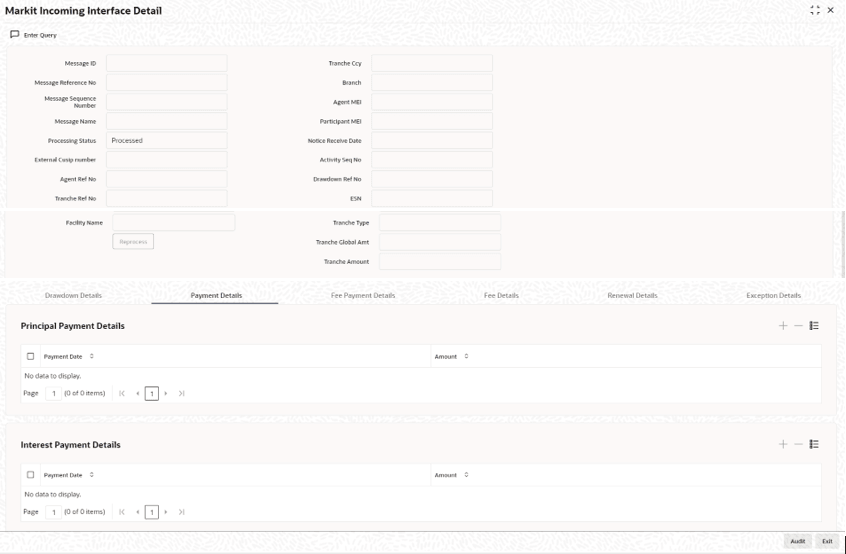

14.17.9 Principal Repayment Notice (Scheduled / Unscheduled)
Incoming messages with Message Name as Repayment Notice is placed in the Incoming Browser with Processing Status as Pending. You can view and process it by clicking Details button against the message. The Interest & Principal Payment Details screen is displayed as shown below.
Figure 14-8 Principal Payment Details
