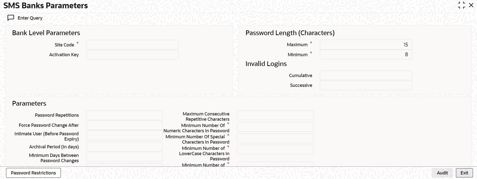

  1. On Homescreen, type SMDBANKP in the text box, and click Next.
    The SMS Banks Parameters screen displays.
    Figure 1-1 SMS Banks Parameters
    The bank parameters can be modified only when the Head Office branch is in the transaction input stage.
  2. On the SMS Banks Parameters screen, specify the fields.

    Bank Level Parameters
    Table 1-2 Bank Level Parameters - Field Description
    Field Description
    Site Code Specify the Site Code.
    Activation Key The system displays the activation key.
    Password Length (Characters) - Indicate the range of length (in terms of the number of characters) of a user password. The number of characters in a user password is not allowed to exceed the maximum length or fall below the minimum length that is specified here.
