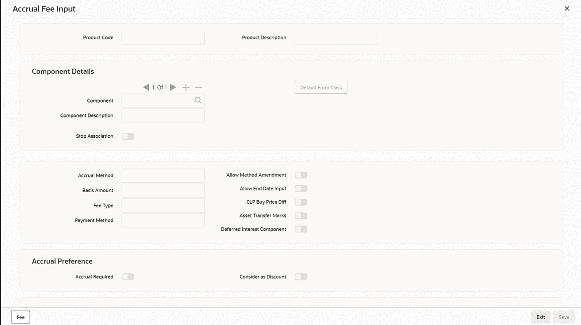

  1. From the Bilateral Loans Product Definition screen, click on Accrual Fee Details tab.
    The Accrual Fee Input screen is displayed.
  2. Click Add row to add fee components. Click Default From Class to associate the required fee component with the product. System defaults the parameters of the selected fee component. However, you can change the parameters according to your requirements.
  3. You can specify below details in this screen. For information on fields, refer to the field description table.
    Table 5-1 Accrual Fee Input
    Field Description

    Allow Method Amendment Select this check box to indicate that the amendment method is allowed for the accrual fee component.
    Allow End Date input Select this check box to indicate that the fee component (if applicable for the product involved in the contract) cease to be associated with a contract on the contract ‘End Date.
    CLP Buy Price Diff Select this check box to indicate that the difference between the PAR price (100%) and actual buy price is booked as fee against that component.
    (Notes:
    • For the Commitments associated with the CLP positions, system maintains separate Income and Expense type of amortization FEE components to handle the amortization FEE amount computed based on the price difference between the Buy Price and Par value (100%). In case of premium price quotation for the Buy trades, expense type of amortization FEE is created and Income type is used for Discount Price quotation.
    • These Income and Expense components should be unique for a commitment product. Such Amortization FEE components are identified by flag CLP Buy Price Diff. In a CLP commitment product, system allows one income and one expense type of Amortization FEE components with the flag CLP Buy Price Diff)
    Asset Transfer Marks Select this option to indicate that the amortization fee component is of the asset transfer marks type. This is defaulted to the component level when details of the amortization fee are being entered.
    Accrual Required You have the option to accrue the fee earned on syndication contracts. To do this, you have to check this option.
    Consider as Discount Select this check box to indicate that the discount accrual to the component is applied.
    Deferred Interest Component Select this check box to indicate that this component should represent deferred interest. When the loan status changes to Performing from Non-performing, the system checks the value of the backend parameter ALLOW_REPERFORMING_LOAN_FUNC. If the value of this parameter is Y, the system performs memo interest reversal. Amortization fee liquidation is done on deferred fee interest component for the memo interest amount that is moved to Real GL as part of the reversal.
    (Note: You can maintain only one deferred interest component for a product.)
