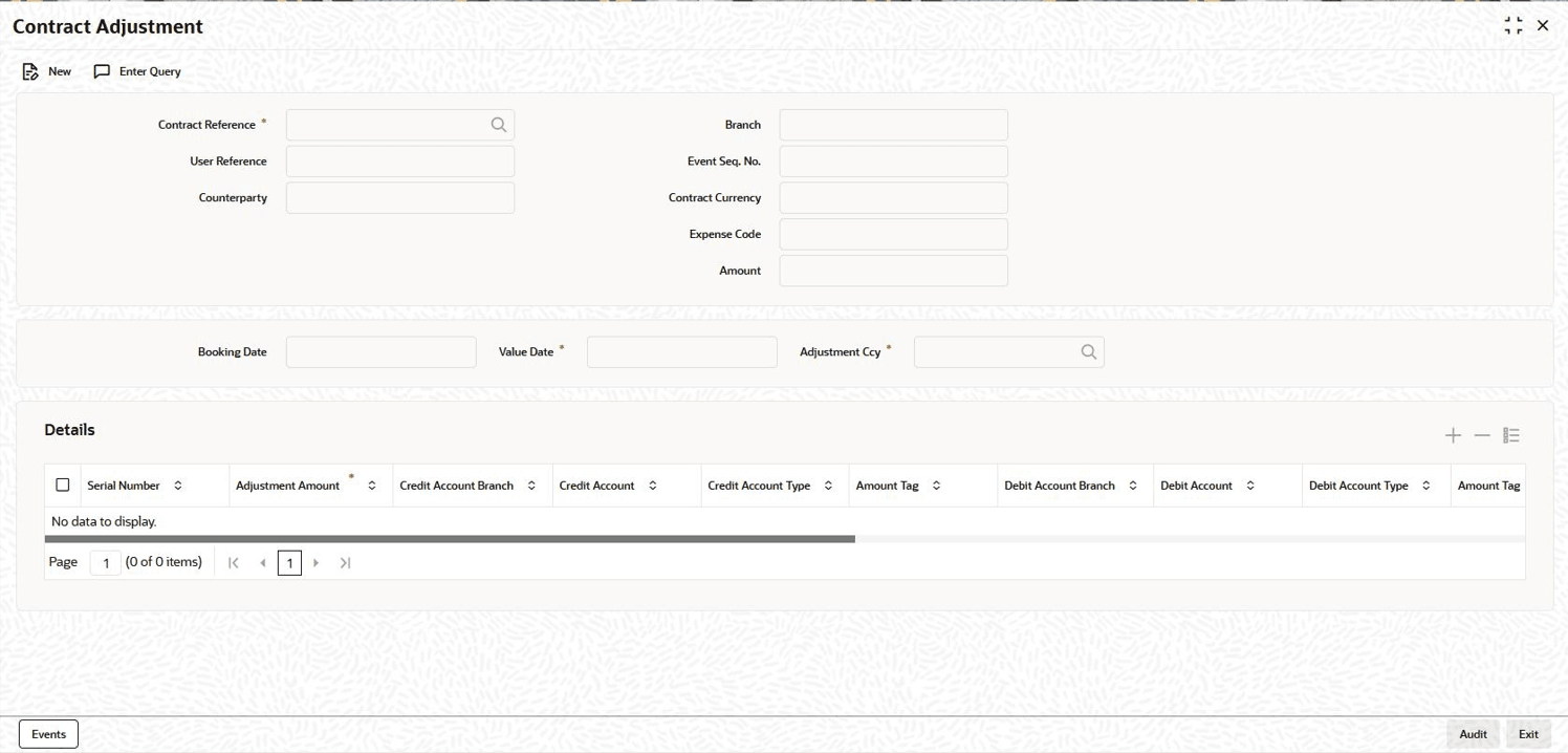

4.6.3 Post Manual Adjustment Entry
You can post manual adjustment entry in Contract Adjustment screen.
Specify the User ID and Password, and login to Homepage.
  1. On the homepage, type OLDLDENT and click next arrow.
    The Contract Adjustment screen is displayed.
    The fields which are marked in asterisk red are mandatory fields.
    Figure 4-16 Contract Adjustment
  2. You can maintain below details in this tab. For information on fields, refer to the field description table.
    Table 4-26 Contract Adjustment
