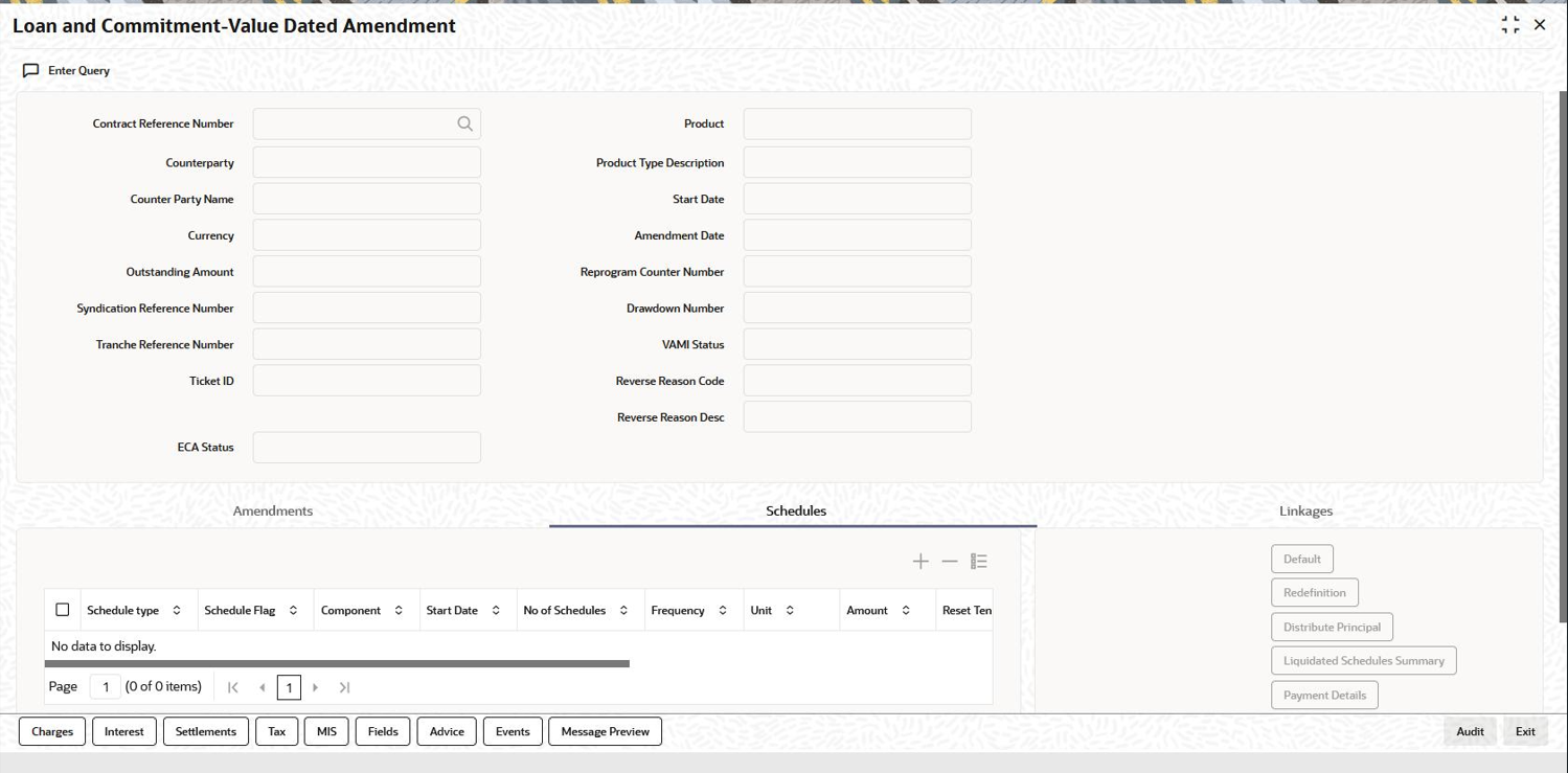

If there is any principal amount increase or maturity date change in the contract, you can distribute the amount equally among all the schedules and redefine the schedules from the amendment date till maturity date. You can do this using Distribute Principal and Redefinition button in Schedules tab of Loan and Commitment Value Dated Amendment screen.
In addition, you can use Default button to default back to the original schedules as in contract and Liquidate Summary Schedule button to view the overdue or liquidated schedules.
Schedule amendments are not allowed for non-bearing, commitment, call, notice maturity type contracts. They are applicable only for loans.
Figure 10-4 Loan and Commitment Value Dated Amendment-Schedules
