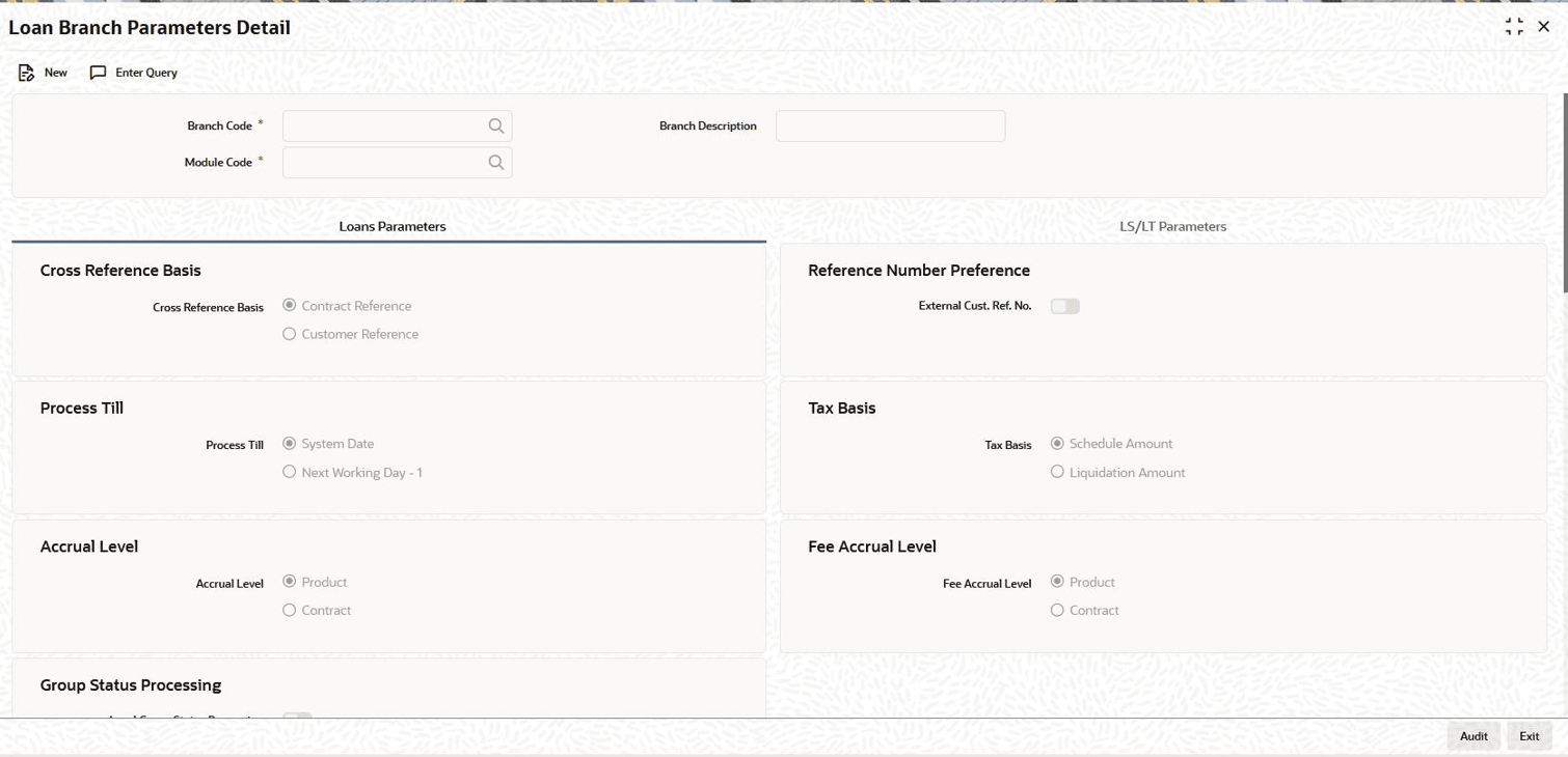

  1. On the homepage, type OLDBRPRM and click next arrow.
    The Loan Branch Parameters Detail screen is displayed.
    The fields which are marked in asterisk red are mandatory fields.
    Figure 2-8 Loan Branch Parameters Detail
  2. You can specify below details in this screen. For information on fields, refer to the field description table.
    Table 2-9 Loan Branch Parameters Detail
    Fields Description
    Branch code Indicates the alphanumeric 3 characters to identify the branch of the bank.
    Module Code Indicate the module code for which the branch maintenance is done.
    Branch Description Indicates the brief description of the branch.
