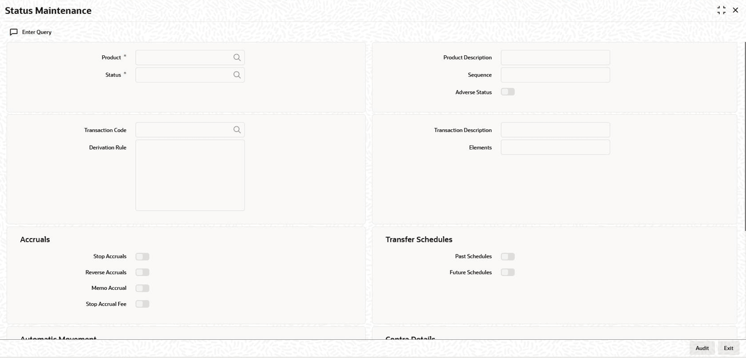

You can maintain the status rules for a product in loan syndication module using the Status Maintenance screen.
Specify the User ID and Password, and login to Homepage.
  1. On the homepage, type OLDSTATS and click next arrow.
    The Status Maintenance screen is displayed.
    The fields which are marked in asterisk red are mandatory fields.
    Figure 2-10 Status Maintenance
    Status Maintenance
  2. You can specify below details in this screen. For information on fields, refer to the field description table.
