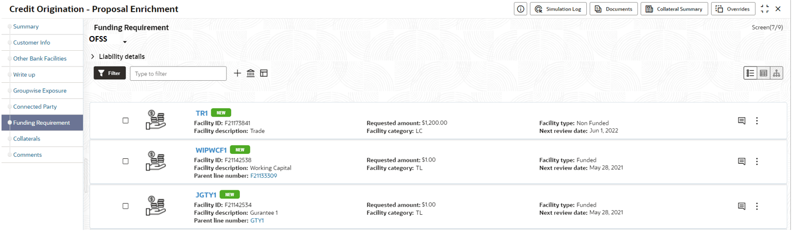

    The Funding Requirement screen displays.
    Figure 4-48 Funding Requirement
  2. Click the action icon in the required facility record and select Edit.
    The Funding Requirement - Facility Details window is displayed.
    Figure 4-49 Funding requirement - Facility Details
