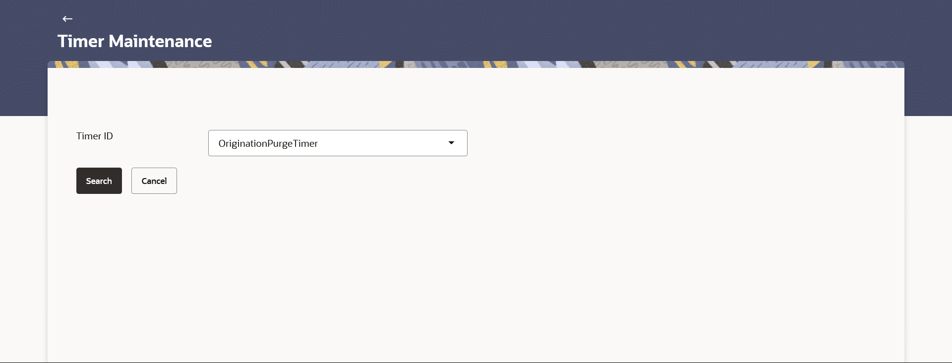

To search and view the timer :
  1. Navigate to the Timer Maintenance screen.
    The Timer Maintenance screen appears.
    Figure 56-1 Timer Maintenance – Search
    The fields which are marked as Required are mandatory.
    Table 56-1 Timer Maintenance – Search - Field Description
    Field Name Description
    Timer ID Name of event for whose timer details to be searched.
  2. From the Timer ID list, select the event whose timer details to be searched.
  3. Click Search.

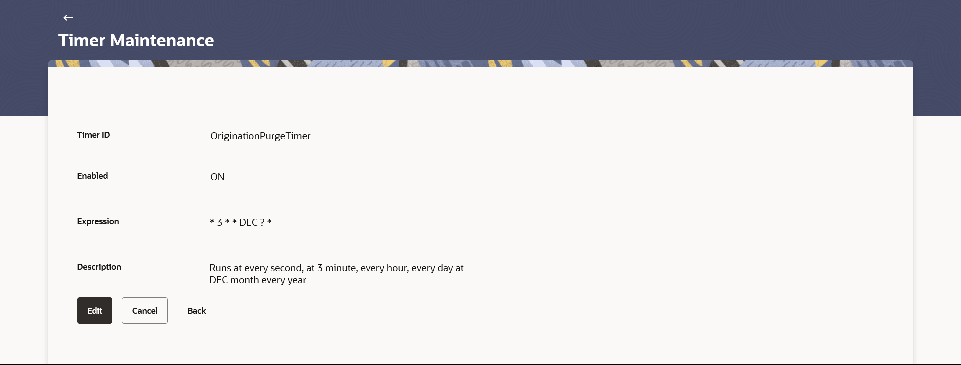

    It displays the details of the selected Timer and show the details in Timer Details screen.
    Figure 56-2 Timer Maintenance – Timer Details (View)
    Table 56-2 Timer Maintenance – Timer Details (View) - Field Description
    Timer ID Name of event for which timer is to be set.
    Enabled Displays the whether the timer is active or not.
    Expression
    Displays the expression set for the selected event.
    The format to set the timer is <Seconds><Minutes><Hours><Day of Month Month><Day Of Week>.
    1. Click the info icon to view the expression format.
    2. Click the Validate Expression to execute the expression and validate it.
    Description Displays the expression details.
