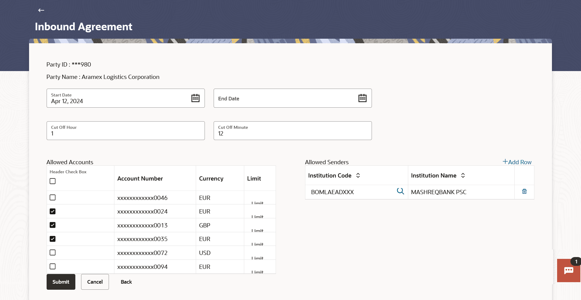

    Figure 12-13 Inbound Agreement

    Table 12-8 Inbound Agreement - Field Description
    Field Name Description
    Party ID Displays the party ID of the user.
    Party Name Displays the party name of the user.
    Start Date The Start Date of the agreement.
    End Date The End Date of the agreement.
    Cut Off Hour Provide the Cutoff hour for the agreement.
    Cut Off Minute Provide the Cutoff minute for the agreement.
    Allowed Accounts Select all the accounts for which Inbound agreement is applicable.
    Account Number Displays all the accounts applicable to the party.
    User can select the accounts for which Inbound Agreement is required.
    Currency Displays currency for each account.
    Limit Displays limit maintained (if any) for each account
    Allowed Senders
    Institution Code The BIC code of the allowed sending institution.
    Institution Name Displays the institution name of the sender.
  2. From the Start Date date picker list, select the start Date of the agreement.
  3. From the End Date date picker list, select the end Date of the agreement.
  4. In the Cut Off Hour field, enter the cut off hour.
  5. In the Cut Off Minute field, enter the cut off minute.
  6. Under the Account Number column, select the checkbox(es) against the accounts for which Inbound Agreement is required.
  7. In the Institution Code field, enter the BIC code of the allowed sending institution, and click on the icon.
    The system displays the Search Swift Code popup window, where user can search by BIC Code & Country or Bank Name & Country. Click Search, system displays the institution name of the sender.
    1. Click the search icon to search Institution code.
    2. Click on the + Add Row to add a new detail record.
    3. Click the delete icon to delete the record.
