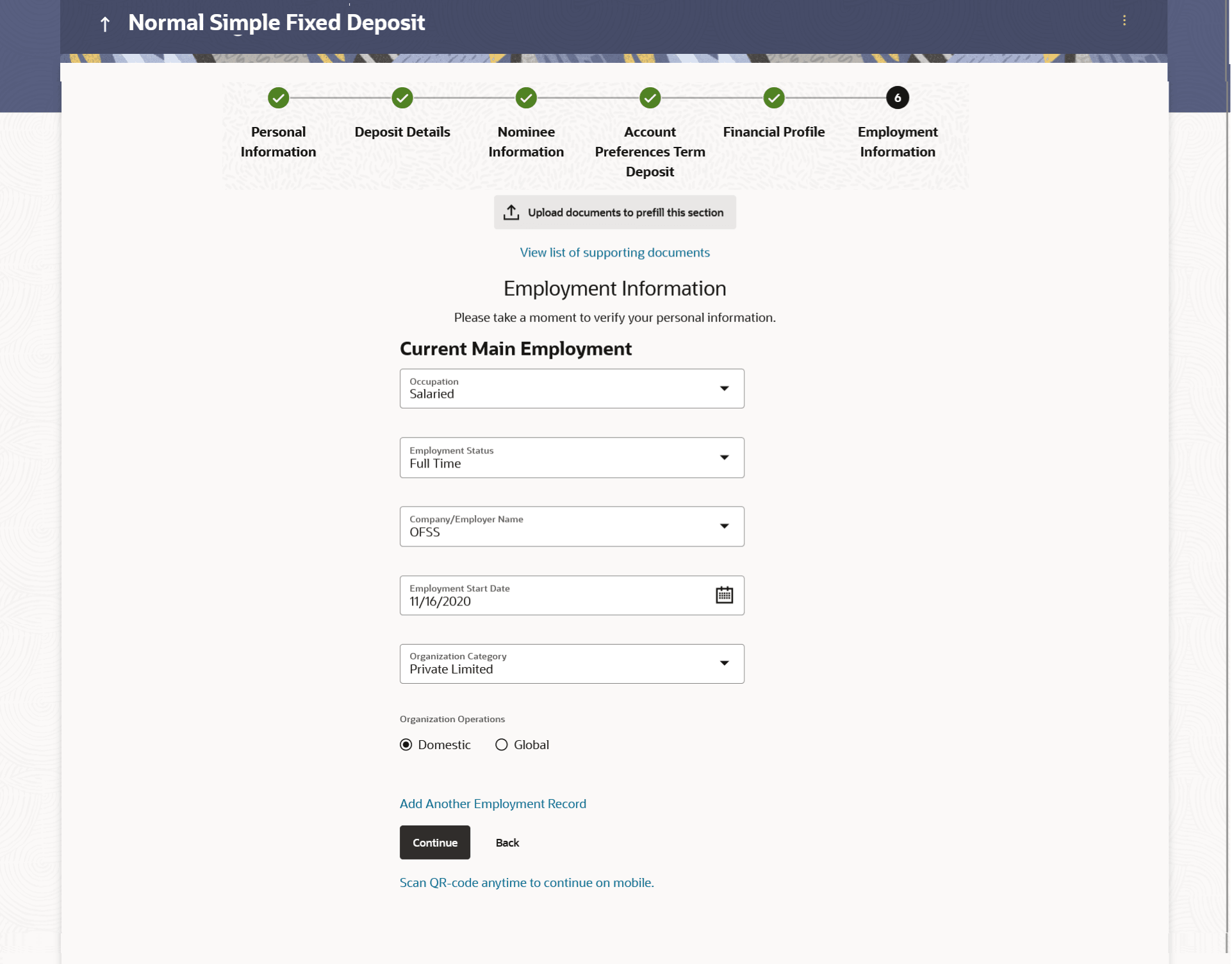

  2. Under Employment Information section, specify the required details.
    Figure 1-17 Employment Information
    The fields which are marked as Required are mandatory.

  3. From the Occupation list, select the occupation in which you are/were involved when employed at the company/business.
    1. Perform any of the following actions:
      1. If you select the option Salaried in the Occupation drop-down list.
        1. From the Employment Status list, select the employment status applicable to you.
        2. From the Company/Employer Name list, select name of the company / employer at which you are employed.
        3. From the Employment Start Date date picker, select the date on which you started working with this employer.
        4. From the Organization Category list, select your category under which the organization with which you are employed, falls.
        5. From the Organization Operations list, select the area of operations of the company/organization with which you are employed.
      2. If you select the option Self Employed/Professional in the Occupation drop-down list.
        1. From the Profession list, select your profession.
        2. From the Company/Firm Name list, select the name of the Company/Firm where you are working.
        3. From the Business Start Date date picker, select the date on which you started working with this business/employer.
