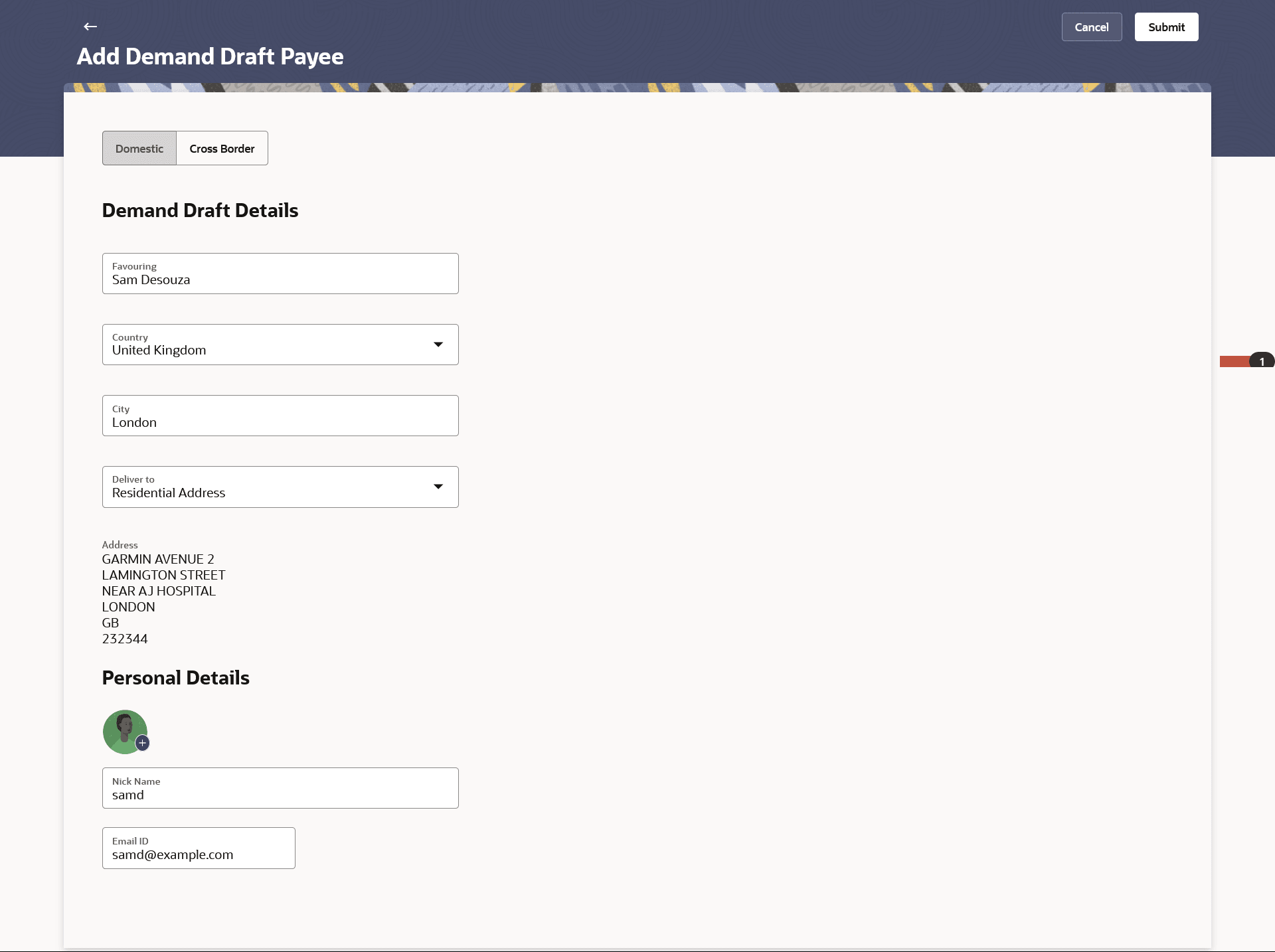

  2. The Add Demand Draft Payee screen appears.
    Figure 2-10 Add Demand Draft Payee - Domestic
    Figure 2-11 Add Demand Draft Payee - Cross Border
    The fields which are marked as Required are mandatory.
    Table 2-6 Add Demand Draft Payee - Domestic - Field Description
    Field Name Description
    Draft Type Specify the type of draft to be associated with the payee.
    It Could be:
    • Domestic
    • Cross Border
    Demand Draft Details Information specified in below fields are related to demand draft details.
    Favouring Specify the name of the payee as it is to be printed on the demand draft.
    Country Specify the country in which the draft is to be payable.
    This field is enabled only for the Cross Border Demand Draft type.
    City Specify the name of the city in which the draft is payable.
    Personal Details Information specified in below fields are related to personal details.
    Upload Photo Select this option to upload a profile photo against the payee.
    Following actions are available on the + icon:
    • Upload – Browse and upload the profile picture.
    • Choose Avatar - Select initials pattern profile picture or picture from suggestions.
    • Remove - Removes the profile picture uploaded.
    This option will only appear if no photo has been uploaded against the payee.
    1. The maximum allowable image size is 1MB, and the accepted formats are limited to JPG and PNG.
    2. Once a photo is uploaded against the payee, click on the + icon and select Upload/Choose Avatar to update the profile picture.
    Nickname Specify a nickname to be assigned to the specific account of the payee for the purpose of easy identification.
    Email ID Email address of the payee.
    Note: This field is provided simply as a base product feature and will be available to send across to the backend Payments Processor during posting a payment. There will be no notifications sent to the payee on this email address by OBDX. Doing any processing of this field would be an implementation time activity.
    Currently, Deliver To fields are not captured on DD creation as it does not fall under the scope of the payments and should instead be managed through integration with core banking systems such as FCUBS or OBA.
  3. Fill the details in the respective field.
  4. In the Nickname field, enter the nickname to be assigned to the payee.
  5. Click Submit.
    The Add Payee - Review screen appears.
  6. The Review screen appears. Verify the details and click Confirm.
    • Click Cancel to cancel the transaction.
    • Click Back to navigate back to Add Payee screen.
    The success message appears along with the transaction reference number and payee details.
