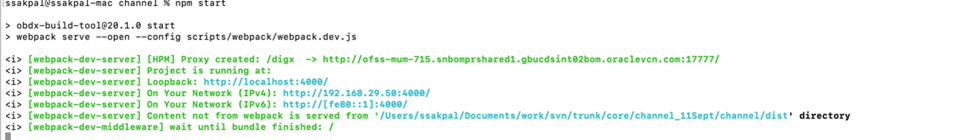

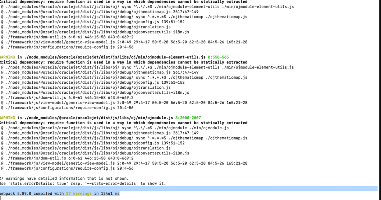

    5. Once the UI is built, run below command to start a local server on the development machine using below command:
      • npm run start
      • Once this server starts, below is the window which appears. This indicates local server is started.
      • Point the “key_server_url” to http://localhost:4000 and run the application on simulator. To run on device, the internet proxy should allow localhost domain to accept incoming requests.
