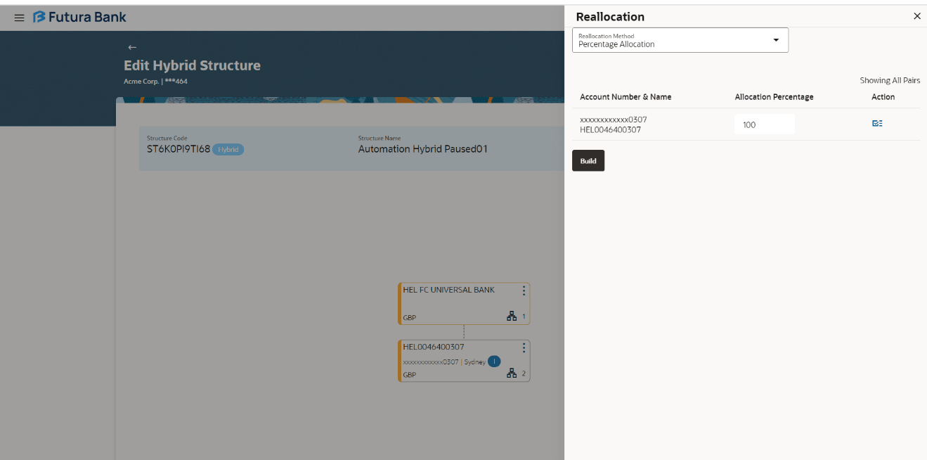

      The Edit Hybrid Structure - Select Reallocation Method & Link Accounts overlay screen displays.
    • Click Reallocation from the account header card. This option will be enabled only if the parent accounts nodes are expanded.
      The Edit Hybrid Structure -Reallocation overlay screen displays.

Once the child accounts are selected, the user can further set the allocation percentage for each child accounts. This screen is applicable only if the Reallocation Method is selected as Percentage Allocation, in which the percentage selection fields such as account number and name, and allocation percentage will be displayed. When a Reallocation Method other than percentage allocation is used, only the reallocation method field is displayed.
  • The Show All Pairs link appears when there are existing child accounts and user is trying to add new nodes at parent level.
  • In cases when the Show All Pairs links appears, user can modify the Percentage Reallocation only after clicking the link.
  • When the Reallocation Method is Percentage Allocation and if the child account is inaccessible, then the inaccessible accounts will be visible to the user in reallocation overlay however user will not be able to modify any values.
Figure 2-126 Edit Hybrid Structure - Reallocation
Table 2-88 Edit Hybrid Structure - Reallocation – Field Description
Field Description
Reallocation Method Displays the method in which the interest is shared with the participating accounts within the account structure.
Note: If the Reallocation Method is selected as Percentage Allocation, in which the percentage selection fields such as account number and name, and allocation percentage will be displayed. When a Reallocation Method other than percentage allocation is used, only the reallocation method field is displayed.
Account Number & Name Displays the account numbers and name of the account in masked format.
Allocation Percentage Specify the allocation percentage for the child account.
  • The sum of the allocation percentage for all the child accounts must be 100. This condition is applicable only for first level (accounts directly linked with notional header).
  • If the user wants to undo link any of the child nodes from the structure, then the user needs to zero the percentage of that node.
  1. Click Edit to modify the allocation percentage for the child account.
  2. In the Allocation Percentage field, specify the allocation percentage for the child account.
  3. Click Update to update the changes made in the percentage allocation for the child account.
  4. Perform any one of the following actions:
    • Click Build to add the child accounts to the header account.
      The Edit Hybrid Structure – Submit screen displays.
    • Click Closeto close the overlay screen.

    • Click Reallocation to update the reallocation method for the pool account pairs. This option will appear only for the parent accounts with the child accounts.
      The Edit Hybrid Structure – Reallocation screen displays.
