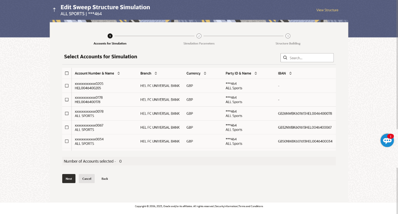

  1. On the View Sweep Structure Simulation screen, click Edit.
    The Edit Sweep Structure Simulation – Accounts for Simulation screen displays.
    Figure 3-49 Edit Sweep Structure Simulation – Accounts for Simulation
    The first step of edit sweep structure simulation involves searching and selecting multiple accounts from the list to edit the simulation structure.
  2. Click Search to search and select the accounts to be added for the structure simulation.
  3. Click Next to navigate to the simulation parameters screen.

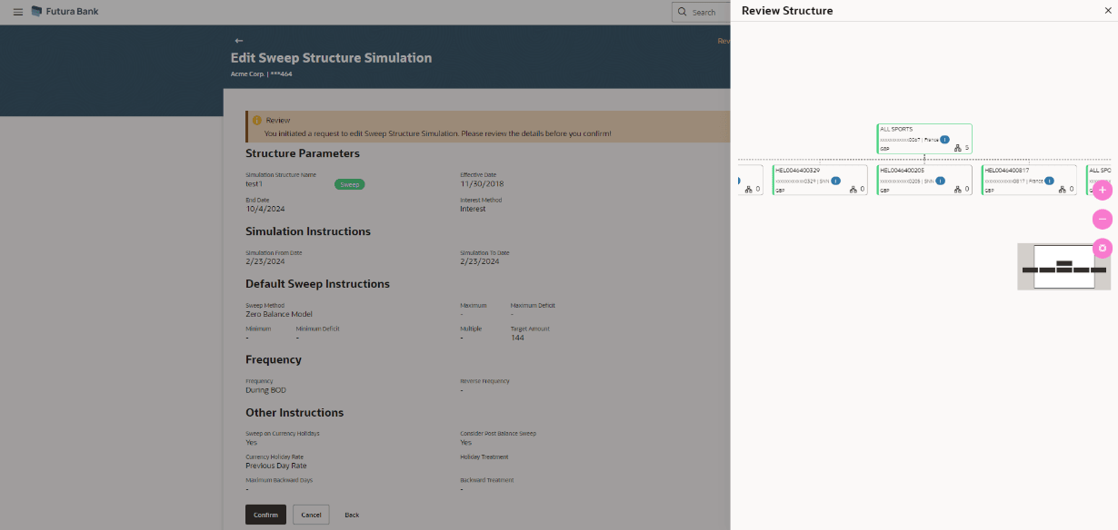

  10. Perform any one of the following actions:
    • Click Next to navigate to Edit Sweep Structure Simulation – Tree View screen.
    • Click Cancel to cancel the operation and navigate back to Dashboard.
    • Click Back to navigate back to the previous screen.

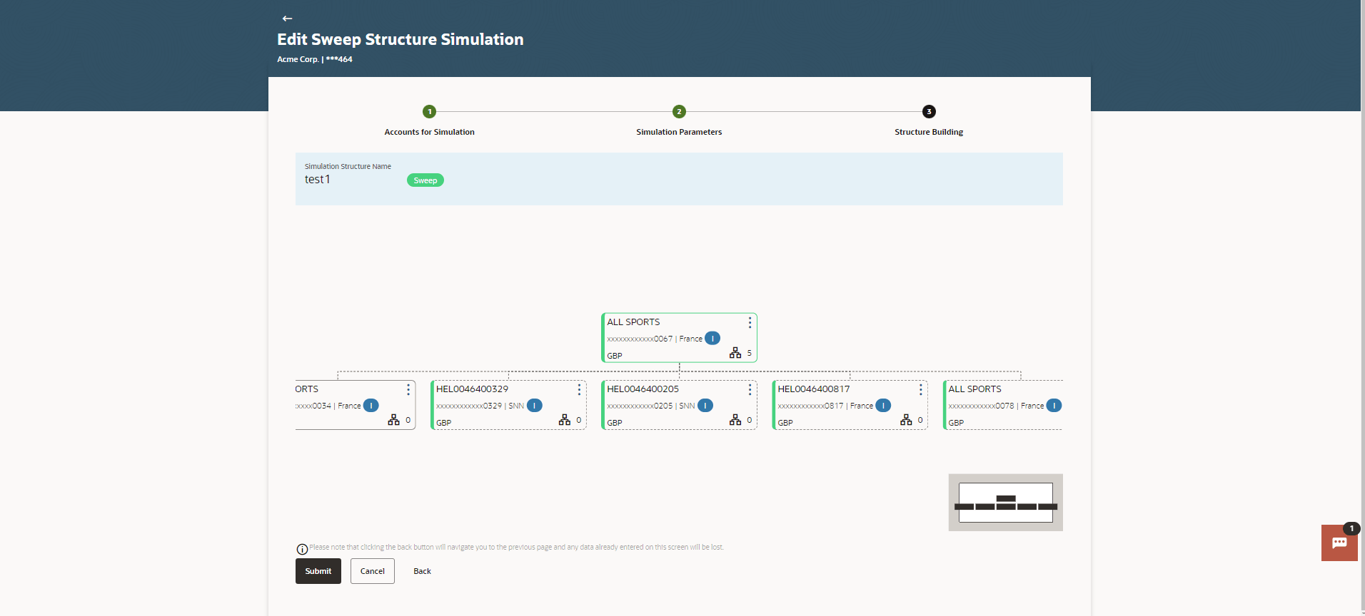

The user can link the new accounts, view the account details of child nodes, delink the existing accounts, and update the instructions for the accounts in the existing structure.
By default, the Build Structure screen displays in tree view.
Figure 3-51 Edit Sweep Structure Simulation – Tree View

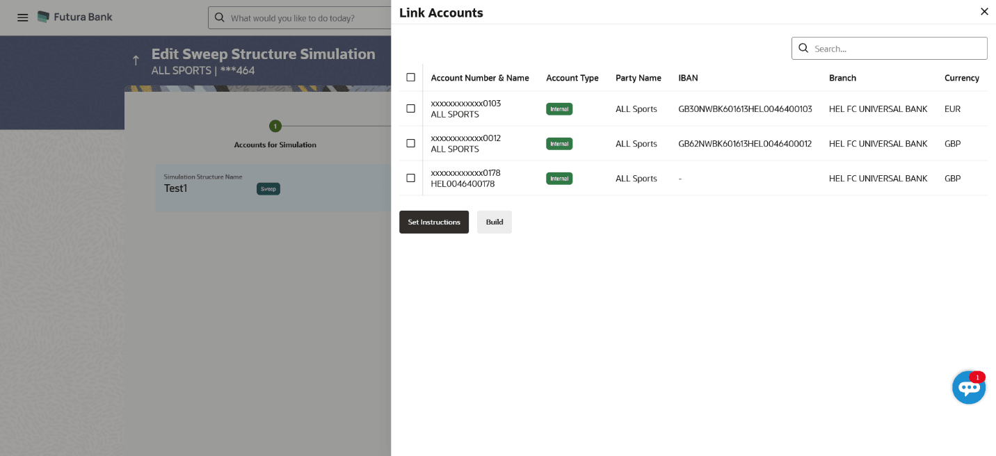

    The user can search and select the accounts to be linked to the selected header/parent account. The filtered account list for which the user has access to will appear for linking the accounts.
    The user can either select the accounts directly in the overlay or can use the UI search to filter and select additional records. In this case, the accounts that were filtered using UI search will appear at the top, while those selected before applying UI search will appear at the bottom.
  2. Select the accounts that the user wants to link to the header account.
    1. In the Search By Party Name, Account Number field, specify and search the complete or partial account details.
      The Edit Sweep Structure Simulation – Link Accounts screen displays the list of accounts that matches across the fields in the table.
    2. Select the accounts that the user want to link to the header account.
    Figure 3-53 Edit Sweep Structure Simulation – Link Accounts
    Table 3-43 Edit Sweep Structure Simulation – Link Accounts – Field Description
    Field Description
    Search Specify and search the complete or partial account details to display the list of accounts that matches across the fields in the table.
    Select All Select the check box to select all the accounts.
    Account Number & Name Displays the account numbers and name of the user in masked format.
    Account Type Displays the type of account.
    The available options are:
    • Internal: An account which is internal to the bank.
    • External : An account which is external to the bank and linked for liquidity management.
    Party Name Displays the name of the party linked to the user's account.
    IBAN Displays the IBAN number of the account.
    Branch Displays the branch name of the user's account.
    Currency Displays the currency of the account.
  3. Perform any one of the following actions:
    • Click Set Instructions.
      The Edit Sweep Structure Simulation - Set Instructions pop-up screen displays.
    • Click Build to use the default instructions and add the child accounts to the header account.
      The Edit Sweep Structure Simulation – Submit screen displays.
    • Click Closeto close the overlay screen.

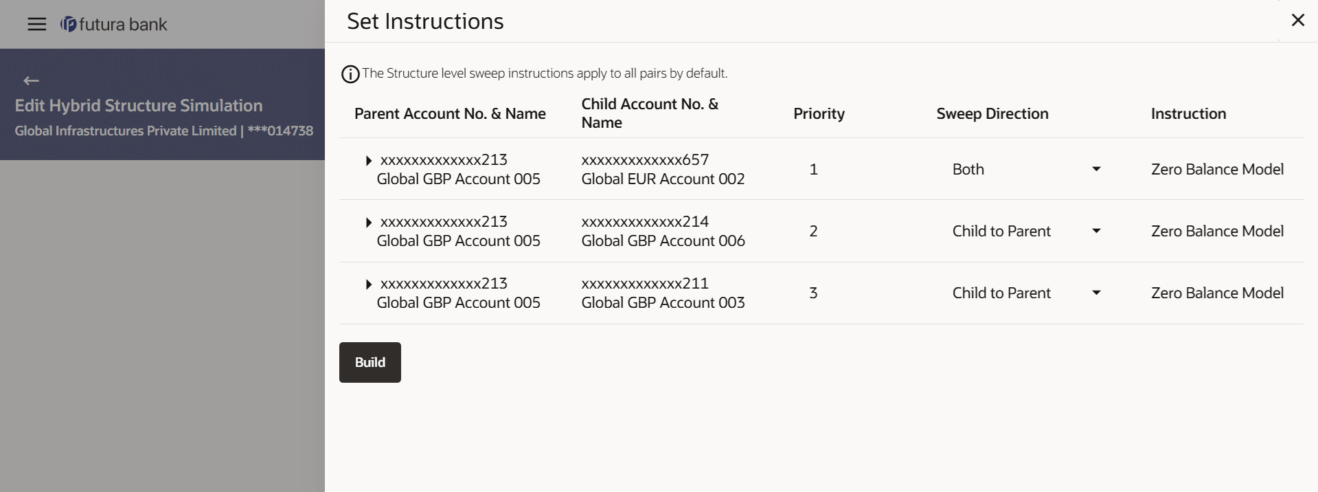

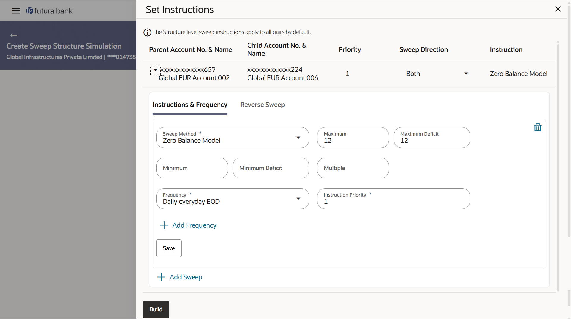

    Once the child accounts are linked, the user can further set the instruction between an account pair along with the parent and child account information.
    Figure 3-54 Edit Sweep Structure Simulation - Set Instructions
    Table 3-44 Edit Sweep Structure Simulation - Set Instructions – Field Description
    Field Description
    Parent Account No & Name Displays the parent account number & name of the structure in masked format.
    Child Account No & Name Displays the child account number & name of the structure in masked format.
    Priority Specify the sweep priority used to determine the order of execution across pairs at a level in the structure.
    Sweep Direction Select the sweep direction for the account pair.
    The options are:
    • Child to Parent - Upward only sweep option to set up child instructions to sweep from child to parent.
    • Both - Sweep option to set up child instructions to sweep from parent to child as well as child to parent. This option gets defaulted during linking a new account.
    Instruction Displays the instruction type for the account pair.

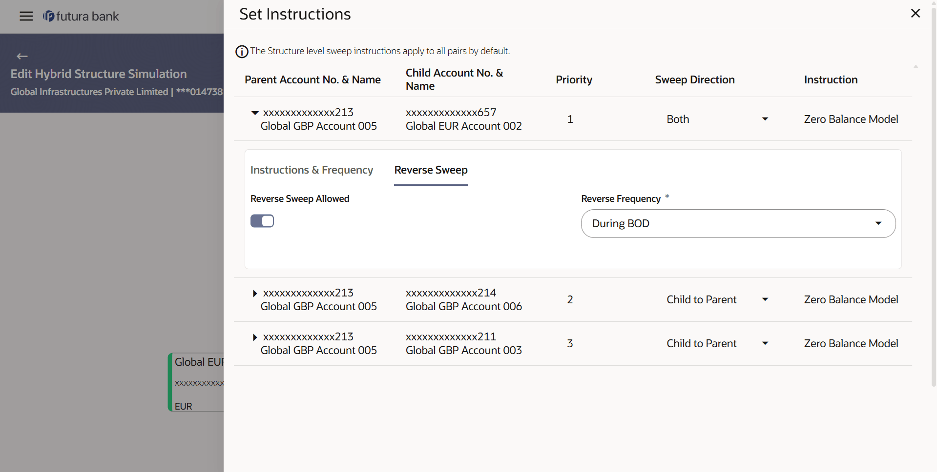

  4. Click Expand to view the instructions for the account pair.
    The user can update the instructions and frequency for the account pair.
    The Edit Sweep Structure Simulation - Set Instructions – Instructions & Frequency screen displays.
    Figure 3-55 Create Sweep Structure Simulation - Set Instructions – Instructions & Frequency
    Table 3-45 Edit Sweep Structure Simulation - Set Instructions – Instructions & Frequency – Field Description
    Field Description
    Sweep Method Select the sweep method set between the account pair from the drop-down list.
    • Zero Balance Model
    • Fixed Amount Model
    • Collar Model
    • Target Model - Constant
    • Target Model - Fixed
    • Threshold Model
    • Range Based Model
    • Cover Overdraft Model
    • Percentage Model
    Value defined as a part of 1st step will be shown in an editable form.
    Frequency Select the frequency at which the account structure should be executed.
    The list displays all the frequencies maintained in the product processor.
    Instruction Priority Specify the instruction priority across multiple instructions within an account pair.
    Parameters Applicability of the below fields varies based on the instruction type selected between the accounts.

  5. In the Instruction & Frequency tab, do the following:
    1. From the Sweep Method list, select the appropriate option.
    2. From the Frequency list, select the appropriate frequency.
    3. In the Instructions Priority field, the instruction priority.
    4. On selection of Sweep Method, the related parameters is displayed with defined values in the editable form.
    5. Click Add Frequency and select the frequency to add multiple frequency.
    6. Click Deleteto delete the frequency.
    7. Click Save to save the sweep method.
    8. Click Editto edit the saved sweep method.
    9. Click Delete to delete the saved sweep method.
    10. Click Add Sweep to add multiple sweep method for the account pair.
    • In a structure, swapping the priority set in two instructions within an account pair is not allowed.
    • To do so, the user will have to delete one of the instructions and then re-add it with the desired priority.

  7. In the Reverse Sweep tab, do the following:
    1. Select the Reverse Sweep Allowed toggle to enable the reverse sweep for the account pair.
    2. From the Reverse Frequency list, select the appropriate option if the Reverse Sweep Allowed toggle is enabled.
      The Edit Sweep Structure Simulation - Set Instructions – Reverse Sweep screen displays.
      Figure 3-56 Edit Sweep Structure Simulation- Set Instructions – Reverse Sweep
      Table 3-46 Edit Sweep Structure Simulation - Set Instructions – Reverse Sweep – Field Description
      Field Description
      Reverse Sweep Allowed Select the toggle to enable the reverse sweep for the account pair.
      Reverse Frequency Select the frequency at which the reverse sweep for the account structure should be executed.
      The list displays the frequencies for which the BOD is enabled.
      Note: This field appears only if the Reverse Sweep Allowed toggle is enabled.

    • Click Build. The Edit Sweep Structure Simulation – Submit screen appears in tree view
    • Click Close to close the overlay screen.
This screen enables the user to view the added parent and child accounts in both the tree view.The Edit Sweep Structure Simulation – Submit - Tree View screen displays
Figure 3-57 Edit Sweep Structure Simulation – Submit - Tree View

    • Click Link to add the additional child accounts for the selected parent account.
      The Edit Sweep Structure Simulation - Link Accounts pop-up screen displays.
    • Click Child Instructions to set the instructions for the account pairs. This option will appear only for the parent accounts with child accounts.
      The Edit Sweep Structure Simulation – Set Instructions screen appears.

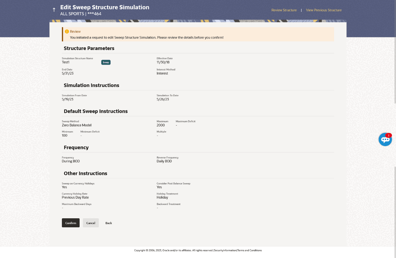

    This screen enables the user to review the updated structure details in the new structure.
    Figure 3-58 Edit Sweep Structure Simulation – Review
  4. Perform any one of the following actions:
    • Click Review Structure to review the structure.
      The Edit Sweep Structure Simulation – Review Structure overlay screen displays.
    • Click Confirm to create the sweep structure.
      The success message appears along with the status and simulation structure details.

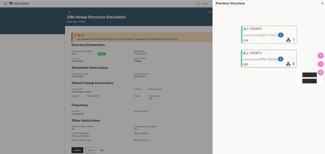

    Figure 3-59 Edit Sweep Structure Simulation – Review Structure
    Figure 3-60 Edit Sweep Structure Simulation– Previous Structure
