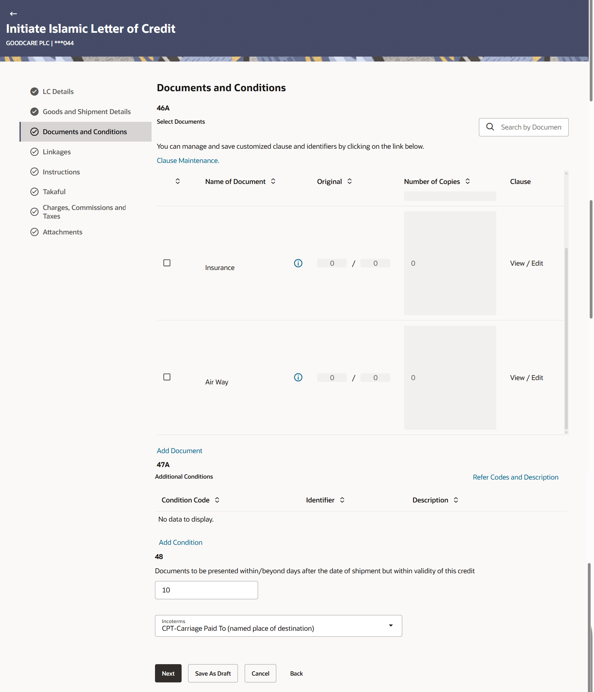

3.5.3 Documents and Conditions
This topic provides the systematic instructions to specify the Documents and Condition details in the application.
This tab includes the INCO terms (International Commercial Terms) and required document details along with the clauses list related to the documents. The document list on this tab are populated based on the default LC product(s) mapped which is conventional as well as Islamic. It also provides an option to add a additional conditions in which corporate user can enter the details to have a clause customized to his/her requirement.
  1. Specify the Documents and Conditions details.
    Figure 3-13 Initiate Islamic Letter of Credit - Documents and Conditions tab
    Description of initiate-islamic-letter-credit-documents-and-conditions.png follows
    Description of the illustration initiate-islamic-letter-credit-documents-and-conditions.png
    The fields which are marked as Required are manadatory.
    For more information refer to the field description table below:
    Table 3-12 Initiate Islamic Letter of Credit - Documents and Conditions - Field Description
    Field Name Description
    Select Documents Documents list have the list of documents with check boxes to choose along with the number of original or copies submitted and clauses they cater too.
    Clause Maintenance Click the link to go to the Clause Maintenance screen.
    Checkbox Displays the documents that you have selected from the list.
    The selected documents are to be a part of the initiated Islamic LC. It needs to be checked in order to select it
    Name of Document Displays the name of the document to be sent along with the Islamic LC.
    Original Specify the required number of original documents required for the selected document.
    It is provided as m/n, where m out of n available documents would be submitted to bank.
    Number of Copies Specify the required number of copies required for the selected document..
    Clause The clauses maintained in the bank application for each of the document. A document can have multiple clauses.
    Click the View/Edit link to view the clause maintained in the bank application for each of the document or to modify as per needs.

    Add Document Click the Add Document link to attached the clauses related documents to the selected document.
    Additional Conditions Specify the additional conditions in this section.
    Condition Code Select the additional condition code of the documentary credit.
    The user can add multiple additional condition code by clicking the Add Condition link.
    Identifier Select the maintained identifier of the conditions of the documentary credit.
    Description Display the description of additional conditions of the documentary credit.
    Click the View/Edit link to view and modify the description.

    Documents to be presented within /beyond days after the date of shipment but within validity of this credit Specify the number of days after the date of shipment when the documents will be presented to bank.
    On adding these days to the date of application, it should be within validity period.
    Incoterms Select the INCO terms for the LC application.
  2. Select the Select Documents check box to choose the number of original or copies submitted and clauses.
  3. Specify the number of originals required for the selected document in the Original field.
  4. Specify the number of copies required for the selected document in the Number of Copies field.
  5. In the Clauses section, list of clauses for each document will be listed and a check box is available against various clauses, user can choose amongst various clauses. Select the required clauses for each selected document and click the View/ Edit Clauses link. The View Clause overlay screen appears, if the clause is already maintained.
