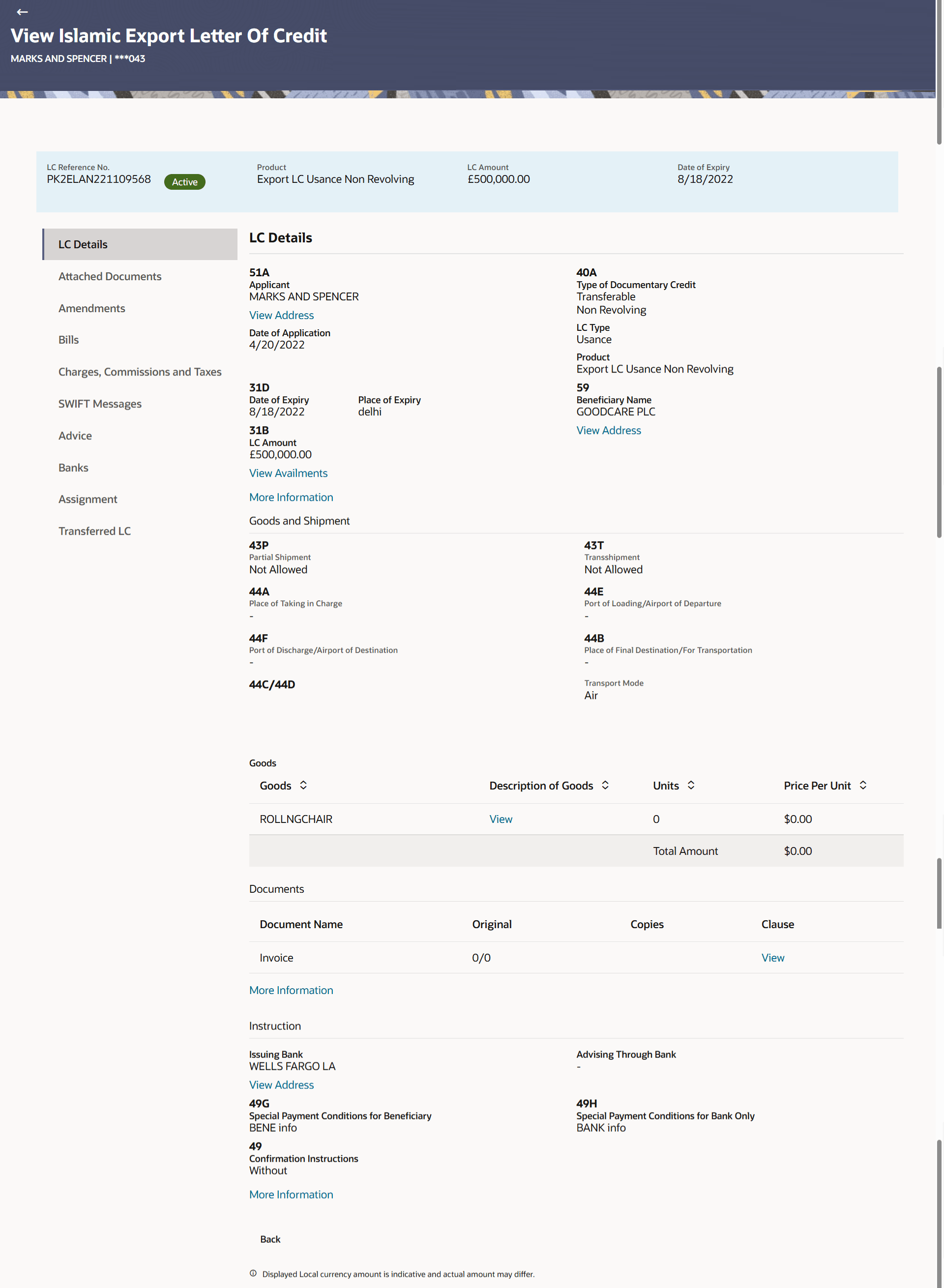

This topic provides the systematic instructions to view an Islamic Export Letter of Credit - LC Details in the application.
View Islamic Export Letter of Credit Details tab captures the general details of the LC application process.
To view an Islamic Export Letter of Credit (LC):
  1. Navigate to View Export Letter of Credit screen.
    On navigation to View Islamic Export Letter of Credit screen, user lands to LC Details tab screen.
    Figure 7-4 View Islamic Export Letter of Credit - LC Details
    For more information refer to the field description table below:

  2. Click the View Availments link to view the availments for LC.
    The Availments for LC overlay screen appears.
