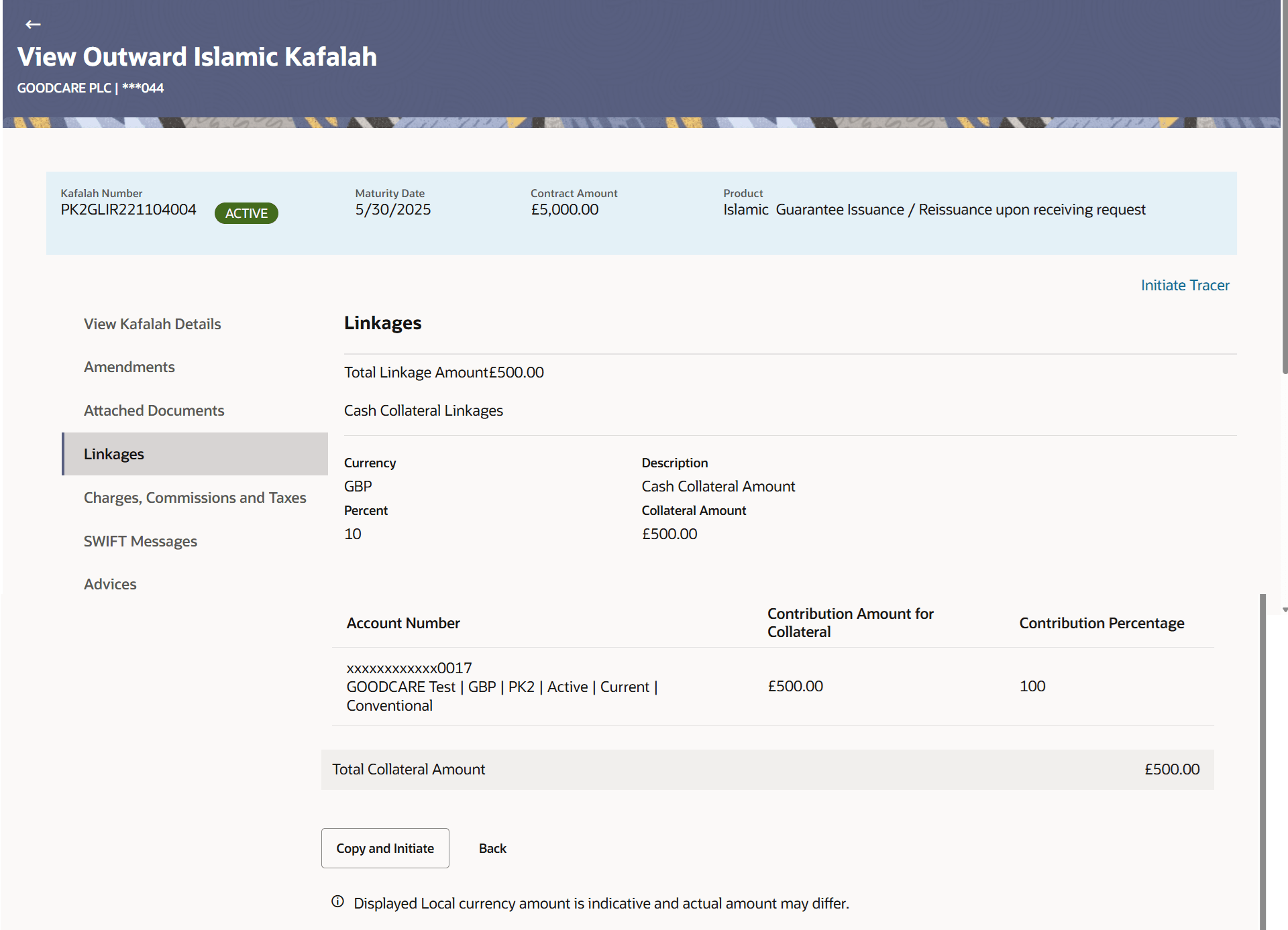

This topic provides the systematic instructions to view the Linkages details in the application.
This tab allows the user to link a deposit account while initiating a transaction.
To view the linkages details:
  1. Navigate to the Linkages tab.
    Figure 24-7 View Outward Islamic Kafalah - Linkages tab
    For more information refer to the field description table below:

  2. Perform any one of the following actions:
    • Click Copy and Initiate to copy details of Outward Guarantee, and initiate a new Outward Guarantee. The Initiate Outward Guarantee screen appears.
    • Click Initiate Amendment to go to the Initiate Outward Kafalah transaction.
    • Click Back to navigate back to previous screen.
  3. Click Charges, Commissions and Taxes tab to view the Charges, Commissions and Taxes details.
