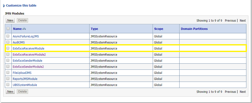

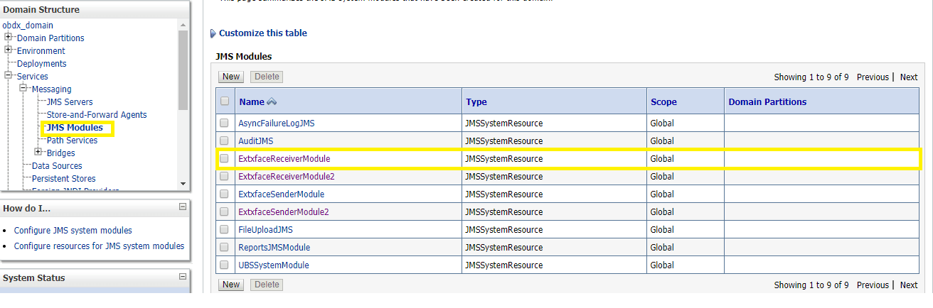

- Services → Messaging → JMS Modules.
- Select ExtxfaceReceiverModule and Click New.

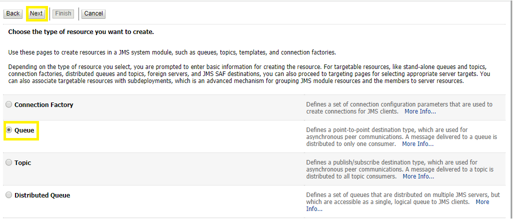

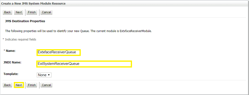

- Select Queueand Click Next.
Name: Provide name of the message queue. example- ExtxfaceReceiverQueue.
JNDI Name: Provide JNDI name. example- ExtSystemReceiverQueue.
Template: None.
- Press Next.

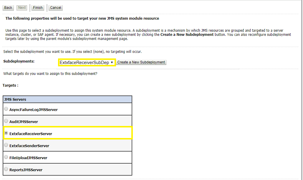

- Subdeployments: Give the name of the sub-deployment name in which Queue is supposed to be added. Example - ExtxfaceReceiverSubDep.
Select the Target as ExtxfaceReceiverServer.
Click Finish.

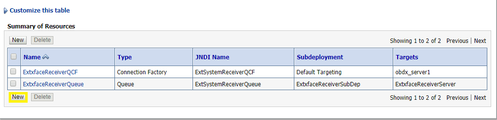

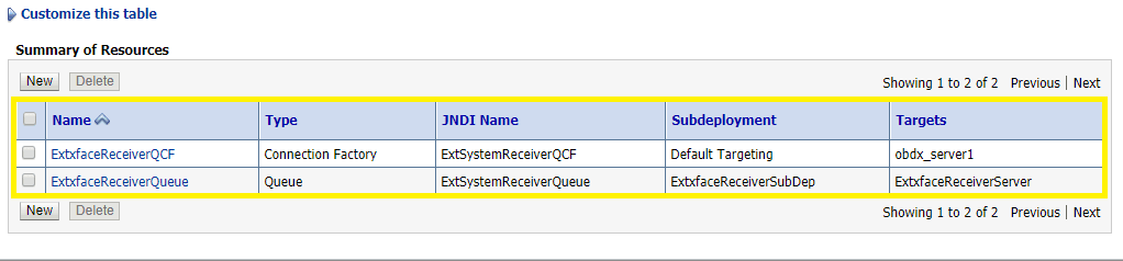

The ReceiverQueueshould be listed on the following page with Sub-deployment as ExtxfaceReceiverSubDep and target as ExtxfaceReceiverServer.
Confirm the resources for the ExtxfaceReceiverModule. Using the Domain Structure tree, navigate to Services → Messaging → JMS Modules then select ExtxfaceReceiverModule.
You should see the following resources:
The JMS queue is now complete and can be accessed using the JNDI names.
ExtSystemReceiverQCF And ExtSystemReceiverQueue.
