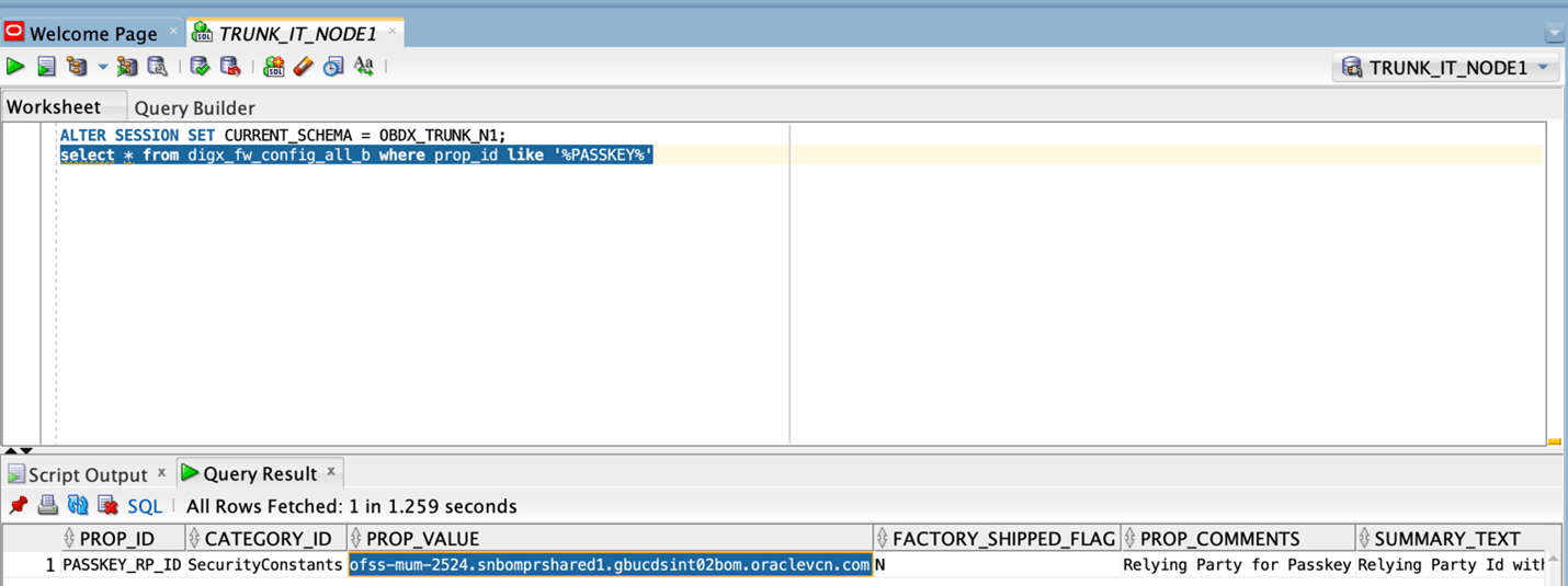

Server-Side Setup:
  1. Update the relying party in below property select prop_value from digx_fw_config_all_b where prop_id='PASSKEY_RP_ID'.
  2. Note:
    Relying partId is the domain name if the website to which credentials will be associated. (Eg google.com, example.com etc)

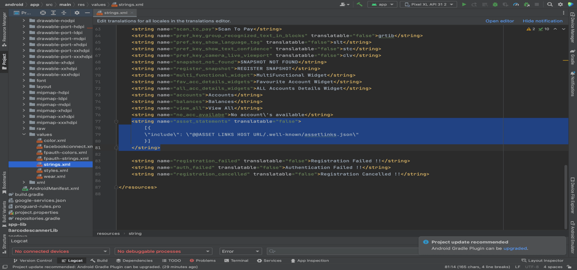

    3. Add assetlinks.json file host in app’s strings.xml file.
