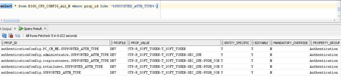

    2. Execute the following SQL query on the DIGX_CFG_CONFIG_ALL_B table to identify relevant configuration entries:
      select * from DIGX_CFG_CONFIG_ALL_B where prop_id like '%SUPPORTED_AUTH_TYPE%';
      Refer to the below attached screenshot for an example of the query and it’s results.
      Description of security261.png follows
    3. For each entry returned by the query above, update the PROP_VALUE by appending your custom ID to the existing value. Separate the new value with a tilde (‘~’).
      Example: If the current value is OTP~R_SOFT_TOKEN~T_SOFT_TOKEN and your custom ID is CUSTOMAUTH, update the value to TP~R_SOFT_TOKEN~T_SOFT_TOKEN~CUSTOMAUTH.
      Sample SQL Update Statement:
      UPDATE DIGX_CFG_CONFIG_ALL_B SET PROP_VALUE = ‘OTP~R_SOFT_TOKEN~T_SOFT_TOKEN~CUSTOMAUTH' WHERE PROP_ID = 'authenticationConfig.SUPPORTED_AUTH_TYPE';
