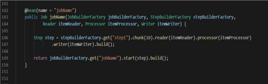

  5. The generated code has two types of batch job template inside.o Simple job creation using spring batch features. The method name for this type of job creation is jobName(). The reader, writer, processor etc are taken from spring’s itemReader, itemWriter, itemProcessor.

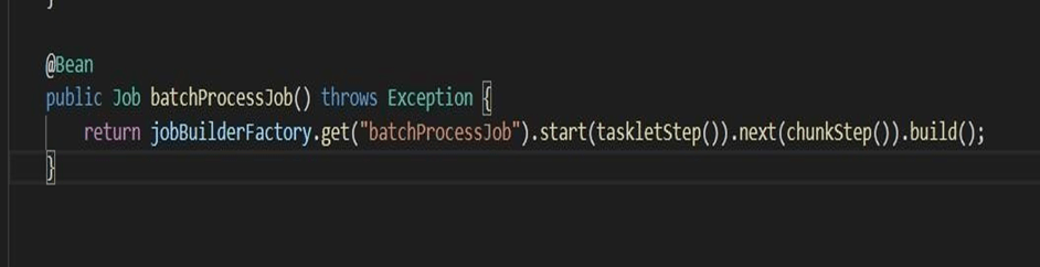

  6. Plato batch type job creation by keeping plato batch into consideration.
  7. The method name for this type of job creation is batchProcessJob(). In this case reader is specified as EReader, writer as TWriter and processor as ETProcessor. E means the entity to be read for this job; T means the transformed object to be persisted in the database. Hence the names are given in that manner.
