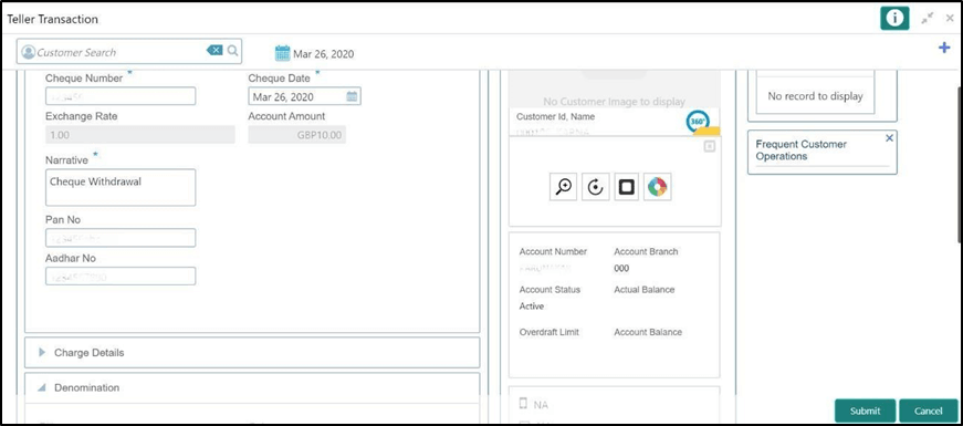

    After deployment, the two additional fields named Pan Number and Aadhaar Number will be added in existing data segment.
  5. Specify the necessary details and click Submit. The additional fields will be saved in respective work and main table in an additional column ADDITIONAL_FIELDS.
    Figure 9-32 Data Segment with Additional Fields

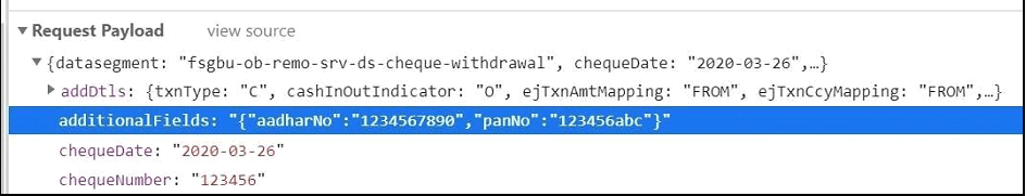

  6. In the request payload from UI to backend, the values appear as follows:
  7. The data will get saved in newly added column Additional Fields in the respective table.
