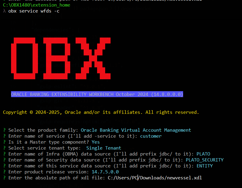

    1. Navigate to same extension_home folder using cmder.
    2. Use the command obx service wfds -c.
      Figure 3-16 OBX service wfds -c
    3. Once this command is fired, this will take you to next section where it will prompt other set of questions. Answer them accordingly to your setup and requirement.
    4. Select the type of component according to your requirement.
    5. Once all the questions are answered and path of XDL is given, it will generate a folder inside the extension_home folder.
