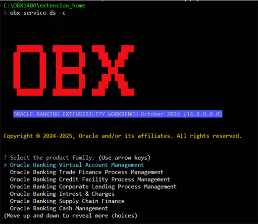

    1. Navigate to same extension_home folder using cmder
    2. Use the command obx service ds -c.
    3. Once this command is fired, this will take user to next section where it will prompt other set of questions. Answer them accordingly to user setup and requirement.
    4. Select the type of component according to user requirement.
