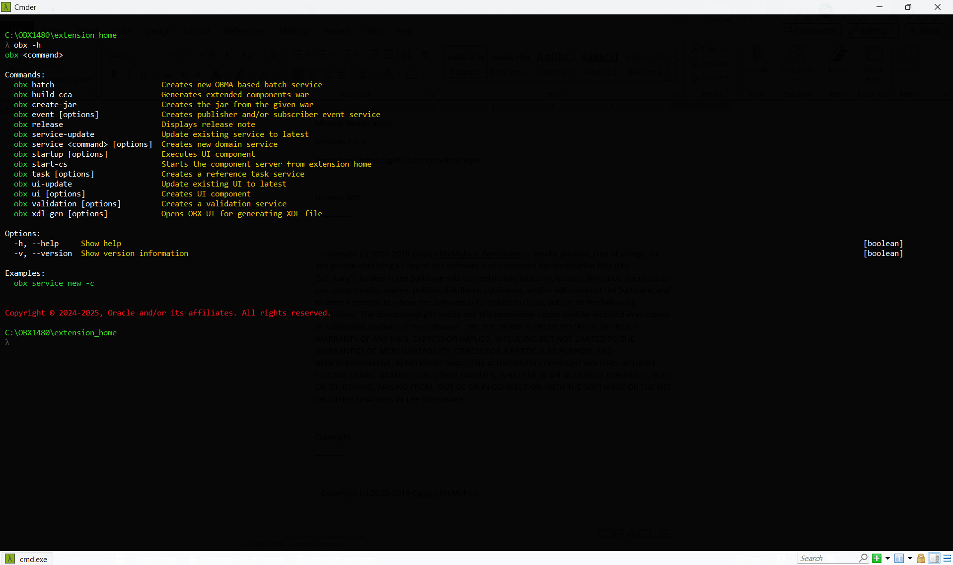

To generate the first artifact, user must first complete the installation process, including the creation of the extension_home folder, and then user should be able to see the help menu as shown below.

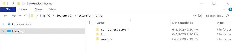

  8. After all the above process extension_home folder looks like below.
    Figure 2-2 Extension Home Folder
